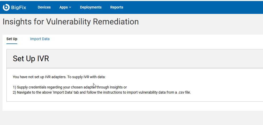

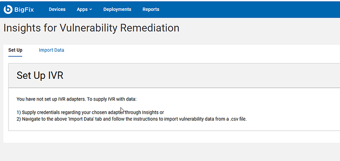

Thanks for the reply. Yes they have which that version we used but thia is what we encountered im webui ivr app.

Yes we did that process. That service was running fine so we thought that we are good but when we checked in webui ivr app as of we did not configured any.

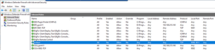

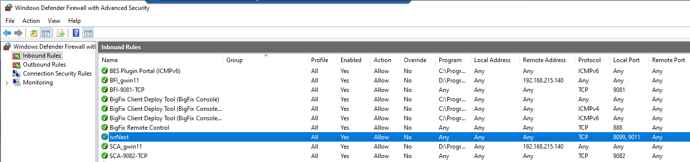

I found that I had to add Defender firewall rules on my Retriever server to allow incoming connections to that service.

I just tried this but port 9011 is open on my server, but still nothing.
