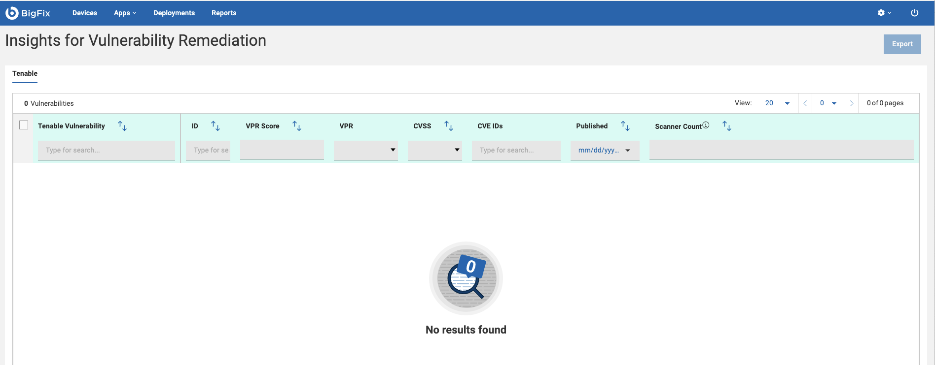

Bigfix on TenableSC
Can you post a screenshot of the error. Thanks.
you are still lucky. Mine is showing that i never configured ivr 4.1.

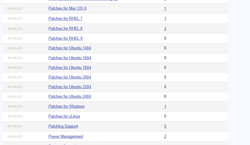

Rich, you require the Patches sites enabled, Computers subscribed to those sites, and current evaluations of those patch Fixlets by the subscribed Computers. I had exactly the same blank report as you did, as my data was really, really old, but as soon as I powered on the subscribed Computers and got a refresh of their applicability to patch Fixlets, my IVR app in WebUI immediately showed me the expected data.

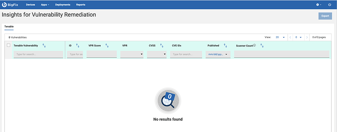

Hi. Yes, i did all of that. Actuallh IVR is pulling data and download going to its SQL BFIvr database my problem is if i will check ivr data in webui app IVR it saying likei never yet set up ivr. BFRetrirver servive is also running.
In addition, all bigfix application are all in one server. Only databases are on a separate server.

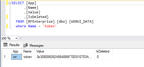

Julius, check your database for this entry, and if it does not exist, you need to go through the setup steps again.
Ok. Yes, i saw this in the log. Btw how this token generated? We repeated tge setup3 t8mes already. Thanks.
I do have the Patches sites enabled. This worked with 2.x before I upgraded.
There was no result found. I donr know how that being generated. I ran the ivr setup but still the query has no result

2025-03-14T19:44:43.708Z bf:ivr:cache:debug No IVR private key found in WebUI Data
2025-03-14T19:44:43.708Z bf:ivr:cache:debug IVR private key not found
