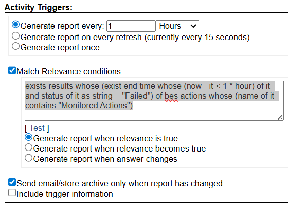

It’s a very old thread, I wouldn’t even bother using API for it (it will take too long to write and requires external schedule/execution)… The easiest way would be directly from Web Reports’ native functionality and session relevance - write yourself the report you need (if you can use the grid, so be it, otherwise it may need custom WR) and then when you schedule it you add sesssion relevance trigger based on whatever it is that you want. For example, something like this should run every hour but will only send you results if it finds actions with the specified name that were executed fully on machines within the last hour and the result of the execution was failure.
exists results whose (exist end time whose (now - it < 1 * hour) of it and status of it as string = "Failed") of bes actions whose (name of it contains "Monitored Actions")
