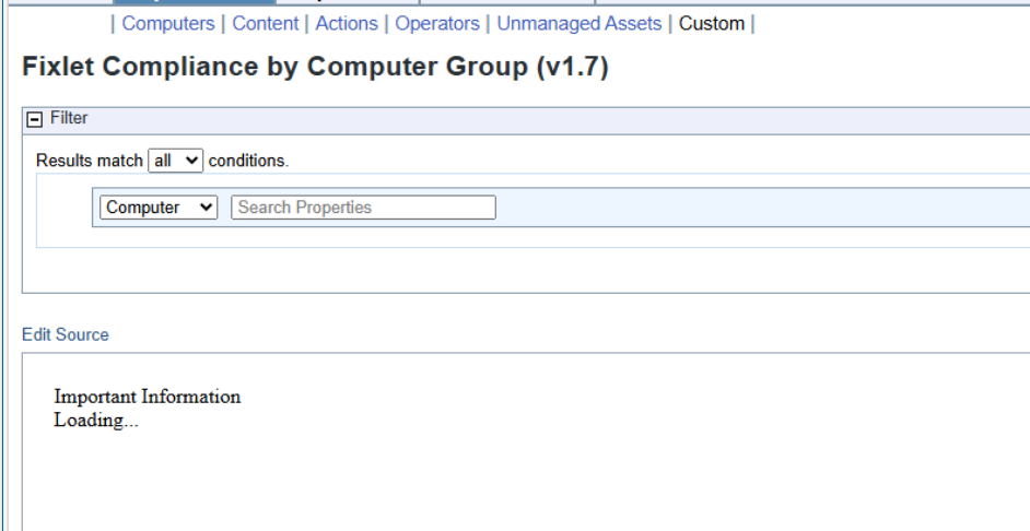

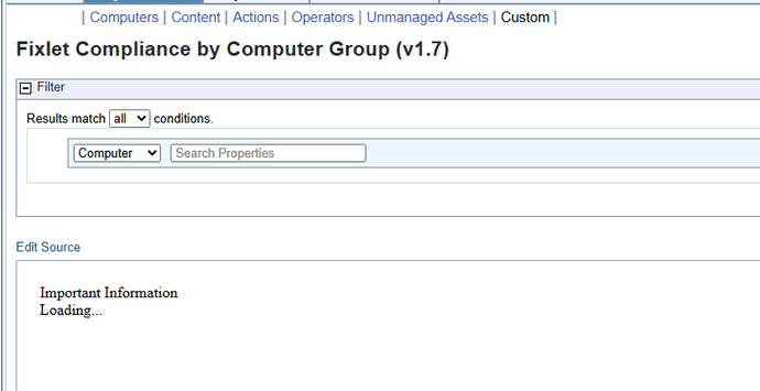

i don’t see any error on the browser. It’s trying to load the page but failed. i have attached screenshot for you. to take a look

Anybody figure this out? Apparently the custom report : Fixlet Compliance by Content v2.0 , does not load anymore after the upgrade to BFv11.
Just stuck on “loading”; and we validated the settings for
