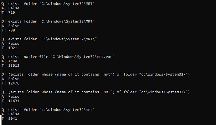

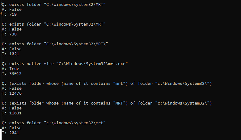

So This was helpful for me to be able to adjust relevance to find a file, however the relevance to find a folder in system32 is not working unfortunately.
Q: exists folder “c:\windows\system32\mrt”
A: False
T: 2041
I have tried all case types and get the same results.
As suggested by Jason above, this is likely due to 32-bit redirection.
See for instance the examples below:
Q: exists folder "c:\windows\system32\mrt"
A: False
I: singular boolean
Q: exists x64 folder "c:\windows\system32\mrt"
A: True
I: singular boolean
