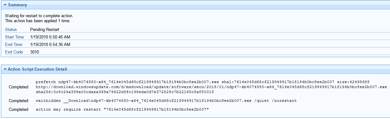

If there’s no exit code, what does the action info tab tell you? You should usually be able to see something like this:
Well, now I feel dumb. I just discovered that one of the fixlets on the baseline that started this question hadn’t had an action selected which of course will make things fail. So, I’ll go back in my corner and think about what I’ve done.
