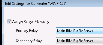

Here is picture or RIGHT clicking and editing a computer with the above setting to “Console” for the controller:
And as you expect I can LOCK and UN-LOCK endpoints. (another note I do use the custom SITE that overrides any locked machine). So then I made a change to the masthead in the console to change this to CLIENT controller. Now when I right click edit an endpoint:
Hmmm lost the ability to do this… but I figure well I can make a Fixlet/Task to do this so I tried but it failed. And looking at the client log:

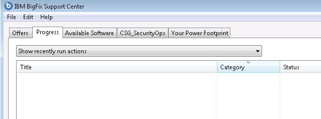

that you could make this an offer or such, but it won’t work. Then I thought MAYBE a new option would show up on my Endpoint Tray Icon:
I was hoping to see the LOCKED check box here (as it is now in control of the client) - but i poked around and found no way from here to do it. I suppose if I MANUALLY changed the registry it would work (i have no tried that). But documentation is lagging here. However I know that if you set this to “Client” then you cannot do much about this via a Task using the commands at your disposal.
