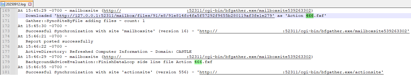

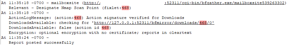

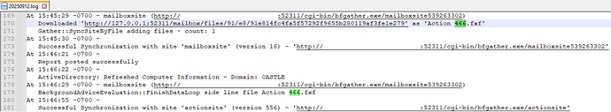

Thanks for asking; Yes. But I’m not sure how to interpret the two lines on which it is referenced:
Seems to me that the action was created with only a 20 minute life. 3:10 to 3:30, and by the time the agent downloaded it at 15:46, it was already expired.
