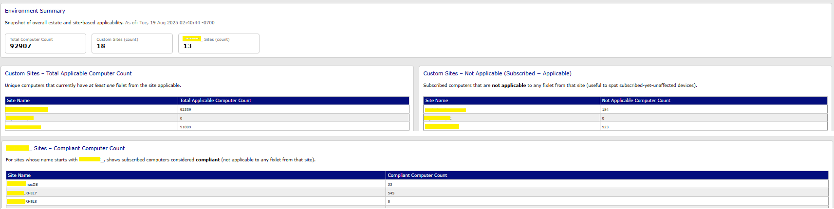

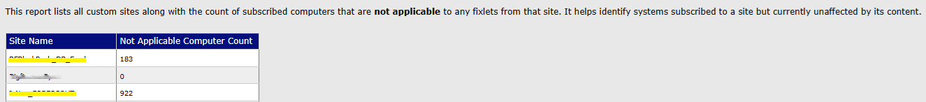

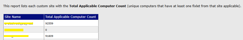

I’ve shared some screenshots above that align closely with your reporting requirements. Please let me know if you’re interested in these reports, I’ll be happy to provide the report files, which you can then use to create your own custom reports.

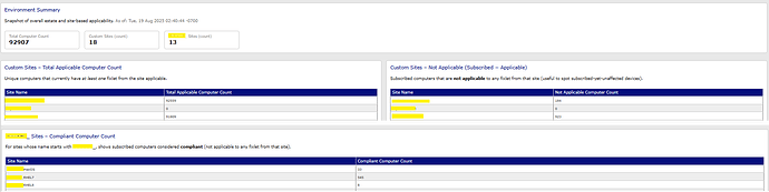

Update: Even all are into one, kind of dashboard reporting
Attached is a PDF file containing all four reports. To use them, follow the method described by @MatthiasW for creating a custom report:

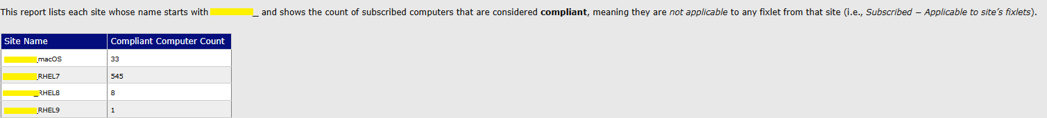

Note: Before using the code for compliance, make sure to update the site name to match your environment.
Search for "MY_COMPLIANCE_SITE" in the last report of pdf and replace it with your actual compliance site name.
