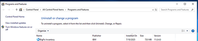

Failed with rc=41 (ya, I saw the blurb on the description tab)

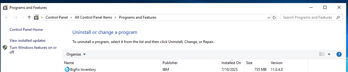

add/remove programs shows 11.0.4 but publisher is IBM (that’s hilarious)
services console shows 11.0.3 in the name of the service
Upgrade to the latest version of BigFix Inventory (11.0.4) is now not relevant on BFI app box

We have upgraded to Inventory 11.0.4 and in Programs and Features it shows the publisher is HCL. Is that where you see IBM?
Yep
