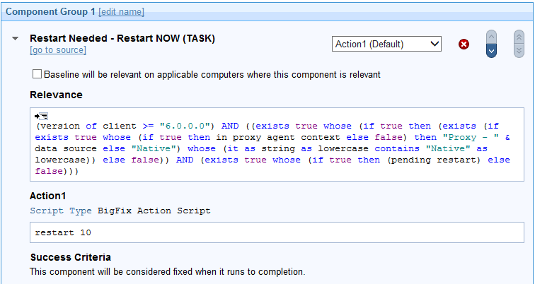

So we have been using a baseline that looks like the following. The key takeaway here is that we check for reboots, reboot when needed, and then try again. Of course if successful on the first try, relevance prevents further again. The upgrade fixlets are standard HCL while the install fixlets are HCL with tweaks to identify missing vmware tools (same actionscript).
Also note that all restart fixlets have the relevant fixlet box unchecked in the baseline.

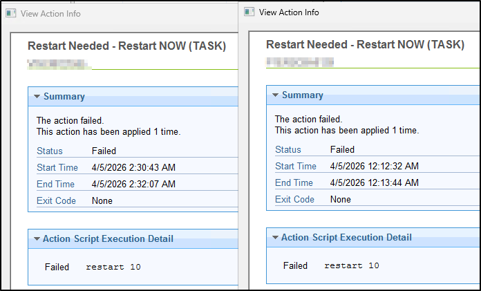

Here are some example failures

The “Restart Needed…” components are all TASKS.
The Install/Upgrade vmware components are all FIXLETS.

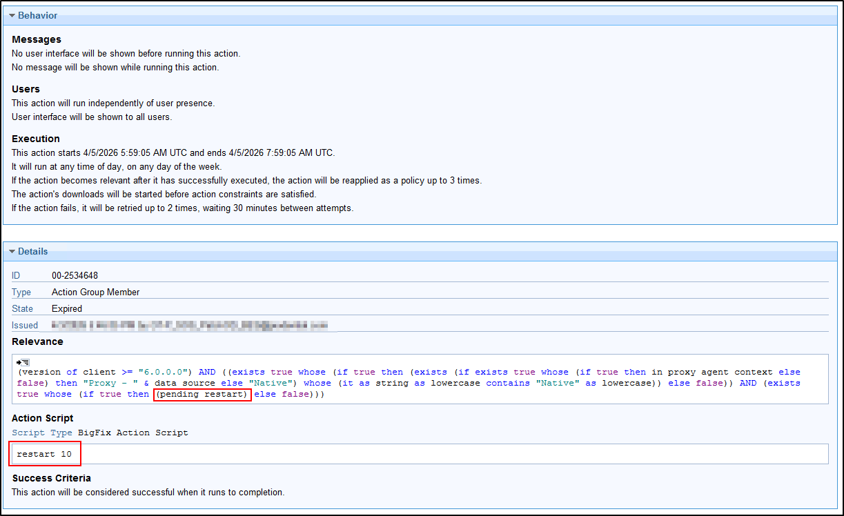

Can you go to the task "view action info"
Like this...
Restarts do for sure occur in this baseline, but from what I can gather reviewing logs is the issue is a situation where the server may switch the active baseline actions following a reboot. At some point during the multiple baseline action executions, relevance for “pending restart” changes true/false and the BigFix client sets the action status to Failed.
Here is a couple examples from the Restart Needed task.
Here is the action settings.

Task success criteria right now is…
There are a few ways to resolve this. One is the change of the success criteria.
