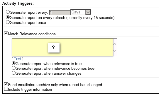

I’m trying to set up an alert that will generate a report any time one of my relay servers reports the relay service as not running. I have a report configured that displays any relays where the relay service does not equal running. I am trying to use an Activity Trigger with Matching Relevance conditions so that it will only generate an email if it finds relays not running. Does anyone have any insight?

Thanks! I am currently using that and it does work but I was looking for a way to send the report based on the relevance. For example if any of my relays go down send the report, but don’t send the report when it comes back up. But I suppose I can work with it the way it is.

You might consider leveraging something like the following for the relevance trigger when it evaluates to ‘true’:
exists results whose (value of it as lowercase contains “yes - stopped”) of bes property “BES Relay Service Installed”
(note that this is the same session relevance used by the Deployment Health Checks dashboard for the ‘BES Relay Service Stopped’ check)…which can be referenced within the DeploymentHealth.ojo/js file in BES Support.
you could try the following
not exist running service “besrelay”
Set the button to Generate report when relevance becomes true
