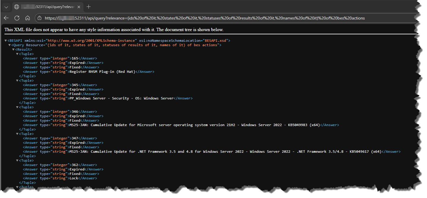

You could post a session relevance expression to the rest api to pull all the actions, or a subset based on whatever your search criteria would be, to pull the data back as an xml or json output, then process that programmatically.
An example of session relevance you may be able to build upon and its XML result
(ids of it, states of it, statuses of results of it, names of it) of bes actions

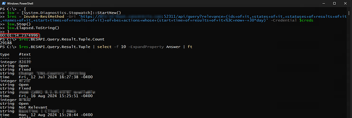

Hi thank you for the reply.
I tried your approach and it looks like it works.
I just had to modify the query to include the start time and filter only tasks older than 30 days.
When running without the filter after 4 hours it drained all the memory of my VM :smiley:
With the filter took under 2 minutes.
That solved my problem, but I’m still curious though, if the API manages multiple requests in parallel. Do you know if it supports? Maybe in the future it will be useful.
Here is the last run:
Thank you!
