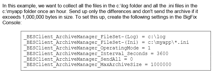

I think you can use upload manager functionality to upload files from client to IEM server. below is the example.
after uploading, you can use some batch file to process the file from IEM server to SMB server. After this verify that file has been copied successfully and you can delete the file from IEM server.
