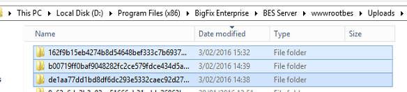

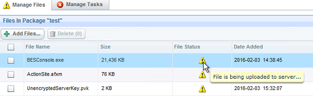

This is what we get when we upload it:

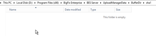

The files are in the uploads:
However, it’s not in the sha1…
When I tried to send an action:

I checked the Uploads on the C:, but it’s not there (because it’s on D: as mentioned in previous screenshots…)
So I do find it strang that this still refers to the C:.. and not the D:.. although it uploads to D:…
