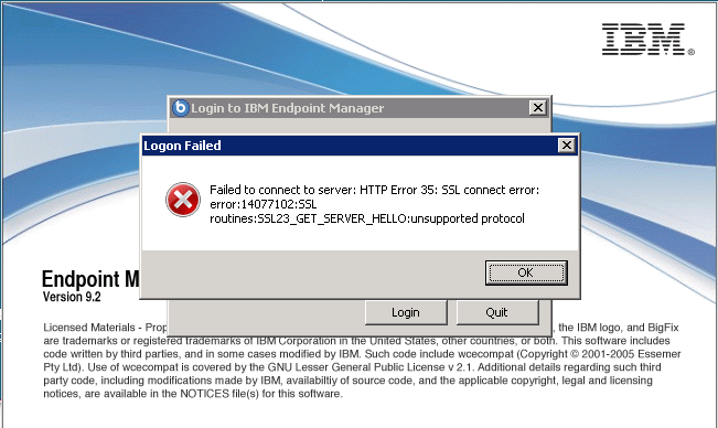

I am upgrade BigFix 9.0.876 to 9.2.1.48 it is install successful but some problem is coming after opening the IBM Endpoint manager console.
Error Message–
Logon Faild: Faild to connect to server: HTTP Erroe 35 : SSL connect Error: error : 14077102:SSL
routines:SSL23_GET_SERVER_HELLO:unsupported protocol.
Please tell me how to solve this problem.

This is the Error Message for after upgrading the , and tell me how to fix this problem.
