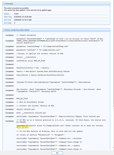

We are attempting to create custom content to update WSL2 on our Windows endpoints to version 2.5.10.0. In theory, this should be fairly simple, as you just need to run “wsl --update” from PowerShell on the affected systems, but I’m trying to confirm the version before/after update by outputting “wsl --version” to a text file. That proved to be more difficult than it sounds, but I think I figured it out.
Right now the fixlet is getting stuck at the “Continue If” statement in the ActionScript on systems where it should return True, and I am not sure why.
Also, even though the PowerShell script to create the text file runs successfully, no text file is present on the target system.
I have attached our content as a .BES. There shouldn’t be any identifying information in there. And I have attached a screenshot of the results from a test run. Please review and let us know if you have any suggestions.

Could you not check the version of the service as a basis of applicability instead of depending on a string in a file created I presume by a sperate process? Hopefully that way your fixlet is only going to run on devices with a version lower than the one you want to update to.
Q: version of service "WSLService"
A: 2.5.10.0
T: 158.970 ms
I: singular version
Q: exists service "WSLService" whose (version of it < "2.5.10.0")
A: False
T: 158.533 ms
I: singular boolean

@SLB Thanks again. The relevance does indeed work as intended.
The deployment failed this time, but I think that is because I was not quoting the PowerShell commands, like so:
waithidden "{parameter "powerShellExe"}" -Command "wsl --update"
