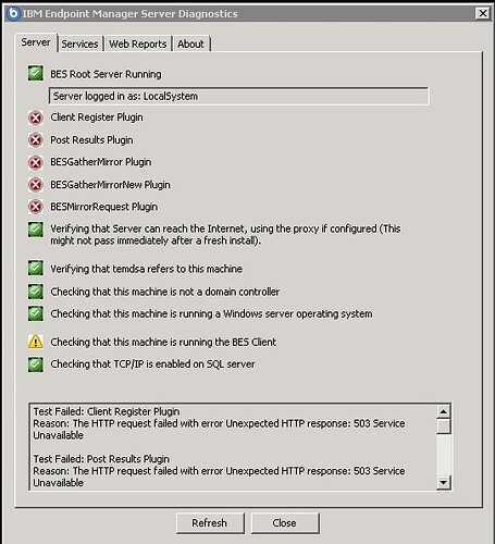

@strawgate Have you seen that screen after installing secondary server (DSA)?
The diagnostics tool looks a lot like that on the DSA server that isn’t replicating. But I’m not sure what that does for us
