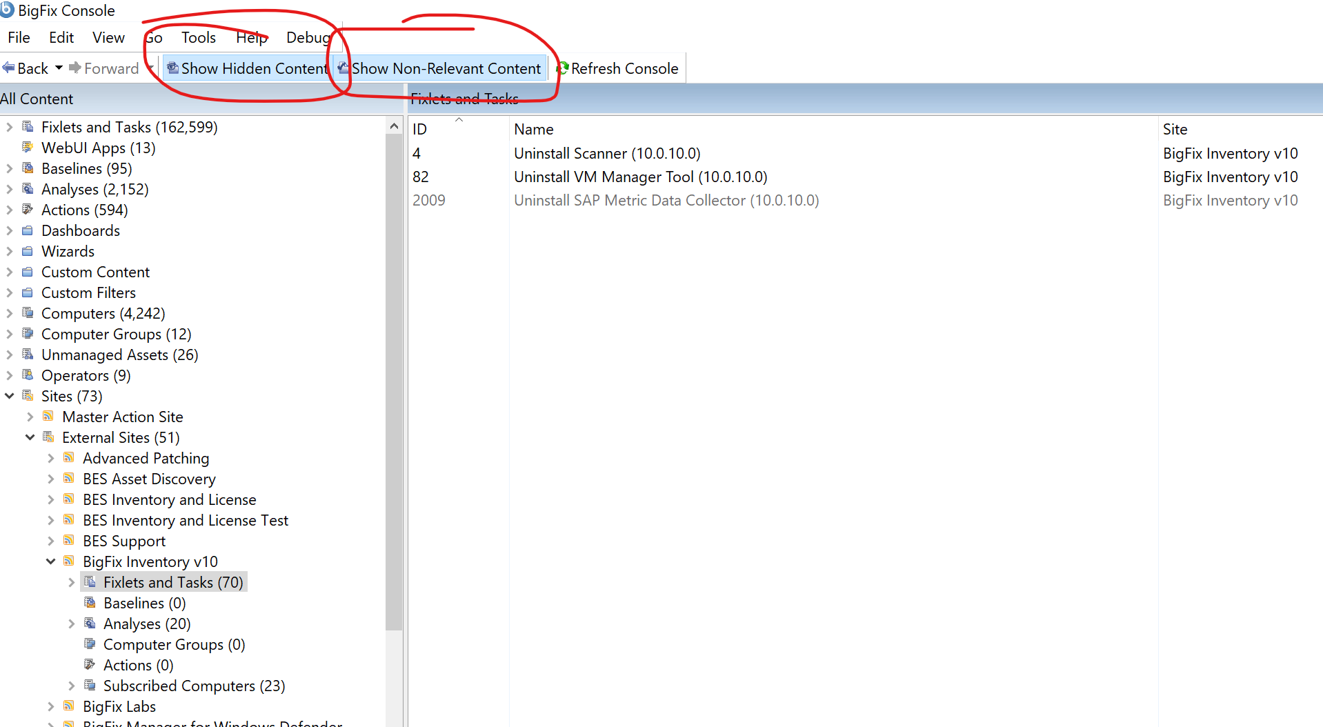

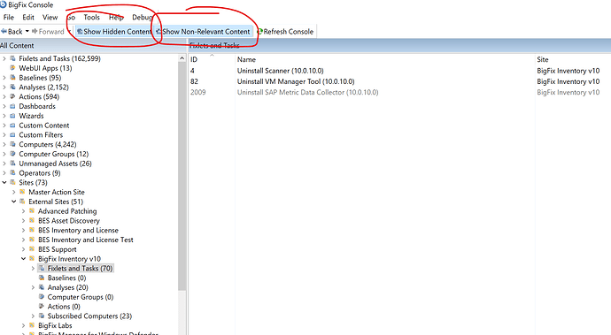

I have checked manually on that server where Vmman.bat file is available which is in root server.
Have you checked these options for “Show Hidden” and “Show Non-Relevant” ?
yes, I have checked these option its not available their.
Has a Master Operator marked the task as “Globally Hidden”? That would prevent a standard operator from seeing the task, even if they selected “Show Hidden Content”.
It would need to be unhidden by a Master Operator - but it’s probably been hidden for good reason, a standard operator should probably not be managing the VM extenders.
