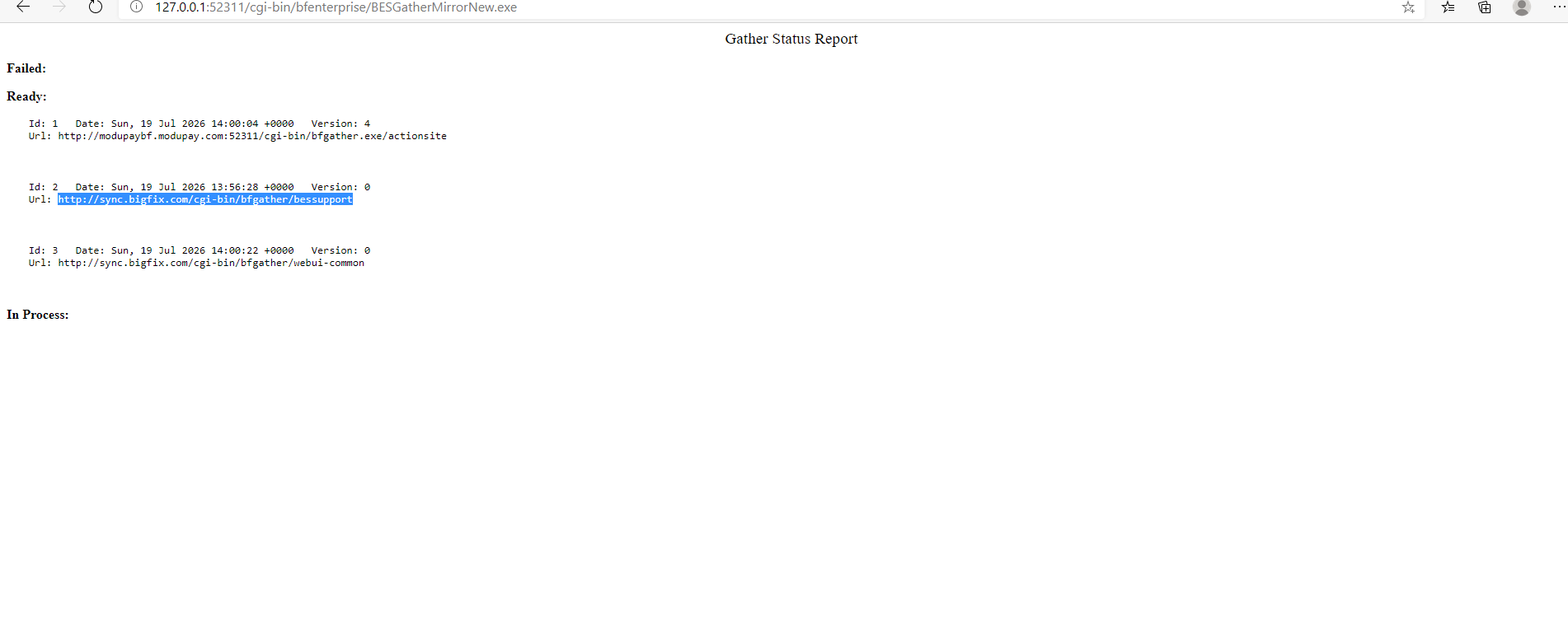

The Gather service is running correctly.
The following local URL is accessible:
http://127.0.0.1:52311/cgi-bin/bfenterprise/BESGatherMirrorNew.exe

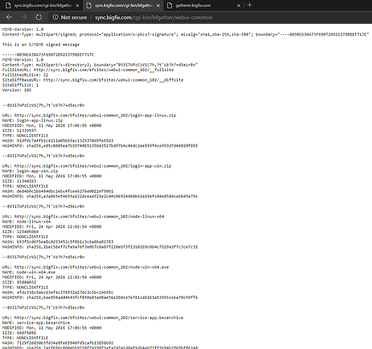

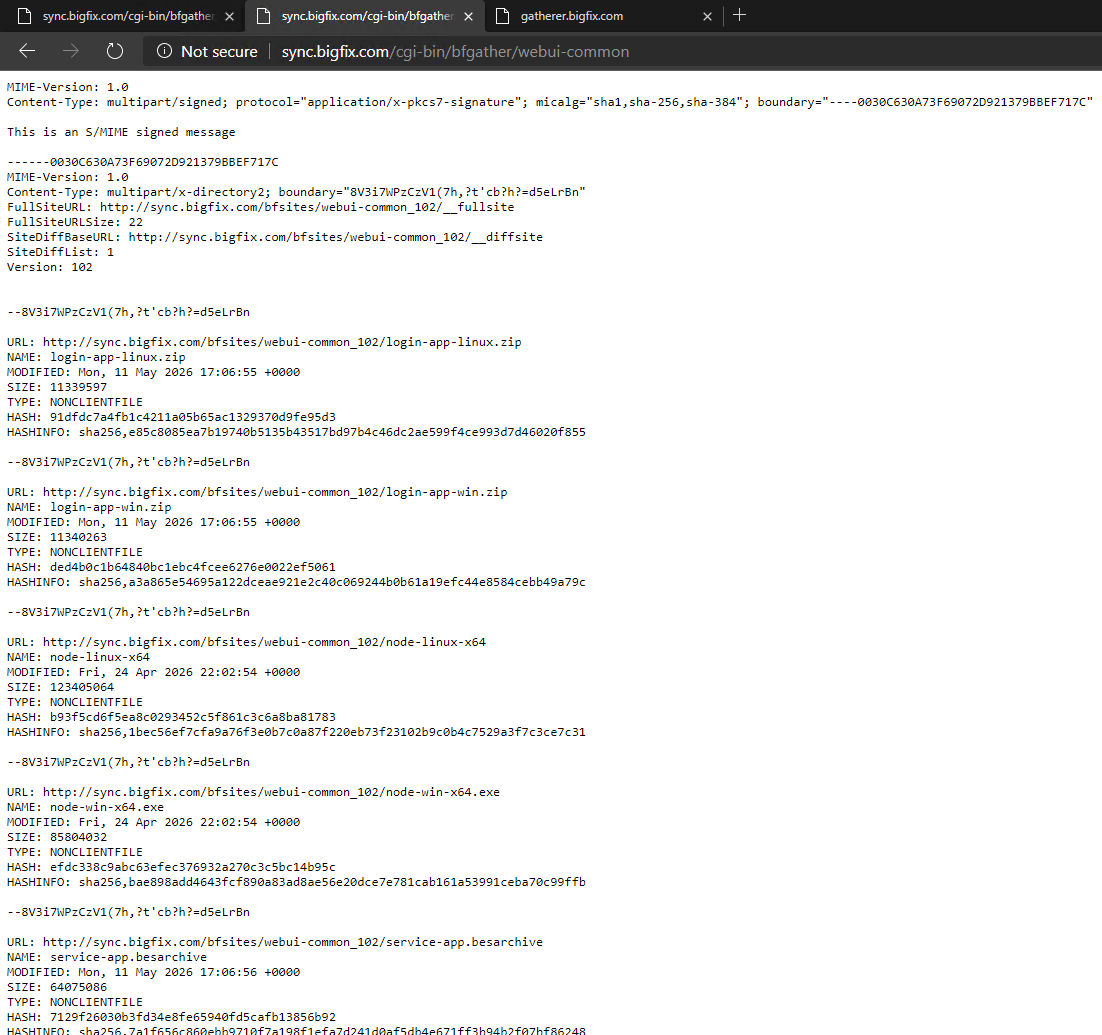

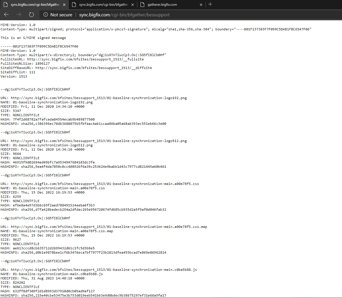

Will double-check with security team, as they tested from browser on the BigFix server, and it works fine even HTTP or HTTPS
The browser is using a different trusted certificate store then the Application , I suggest you to configure as the documentation says and update the results
