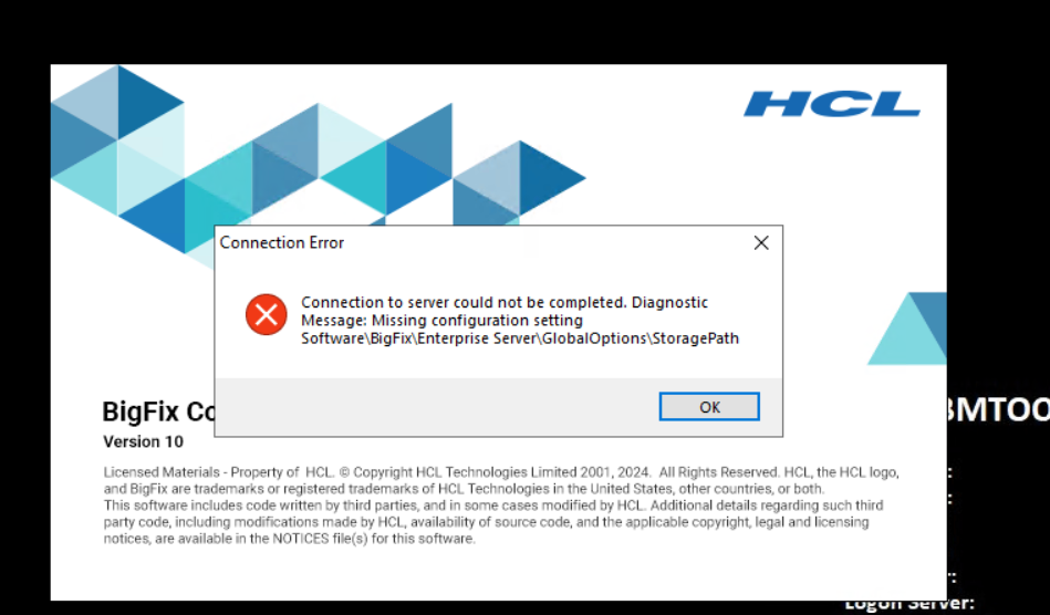

we are having trouble connecting to the BigFix deployed on Linux through console. When we input username password on the console, it gives us this error:
Missing configuration setting Software\BigFix\Enterprise Server\GlobalOptions\StoragePath
Has anyone come across this? I do not see any KB article related to this topic.
Thank you
