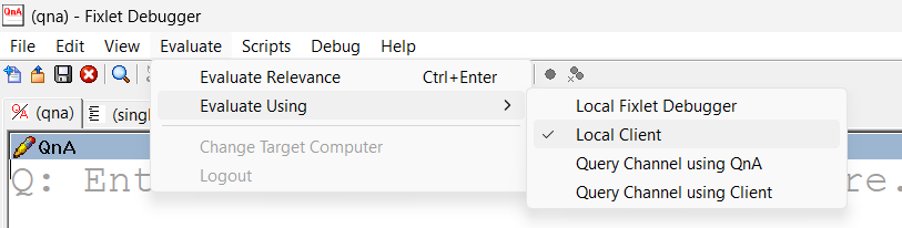

That's a property that is not known to the Fixlet Debugger itself, you have to send this query to the active running client using the debugger option 'Evaluate Using -> Local Client' or the equivalent options in BigFix Query app.
The Fixlet Debugger by default runs outside of the active client, so it's not subject to CPU throttling and it can run on systems that don't even have an installed client. A side-effect of that is that some things (like the current registration, selected server, subscribed sites, etc.) are not available and you have to switch the debugger to 'Local Client' context so it sends the query to the running client instead.
