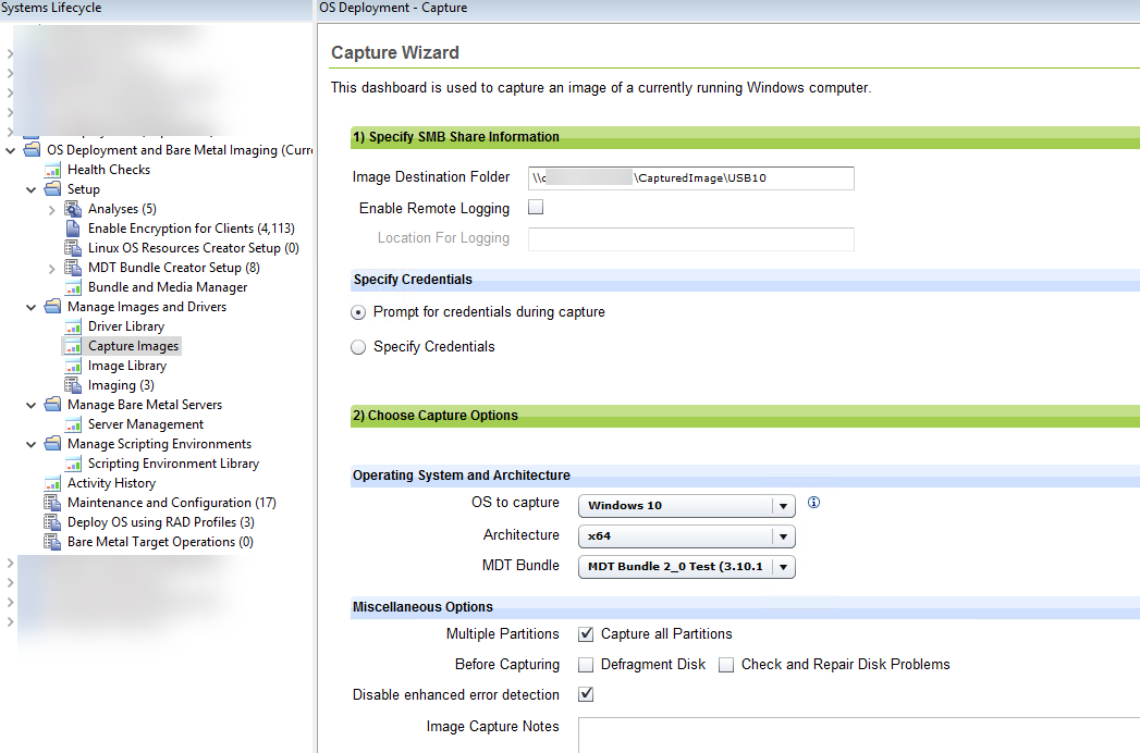

Hi Guys,
Imhaving some trouble trying to capture a new WIM.
I was able to do the first WIM and I have been using it. but now I want to do a separate image with apps installed. and then put it on a USB for Offline deployment. However its not capturing, it completes all the way successfully. But there is no new WIM just new test files o.O
What am I missing? can you only capture one wim unless its a new bundle? I did try different bundles but nothing either.
Im assuming its working as expected :-/ ?

Correct. I’m using the dashboard.
and then it compleates and nothing :frowning:

Looking at the size, the official MDT Bundle seems to be the MDT Bundle 2_0 Test. If no script or task sequence has been changed in it and you still have the same issue, I suggest to open a ticket to product support.
