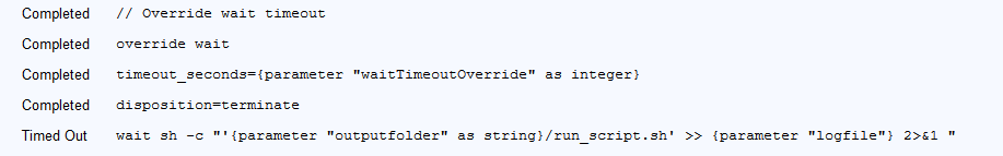

For fixlets that use the override and timeout_seconds, if the timeout is reached, the actions status is “Timeout Reached”
However, when this task is ran in a baseline and it times out, the action status is “Failed”, not “Timeout Reached”.
Not knowing if the baseline results failed vs timed out is causing challenges. Is there a reason why baselines return “Failed” and not “Timeout Reached” ?
