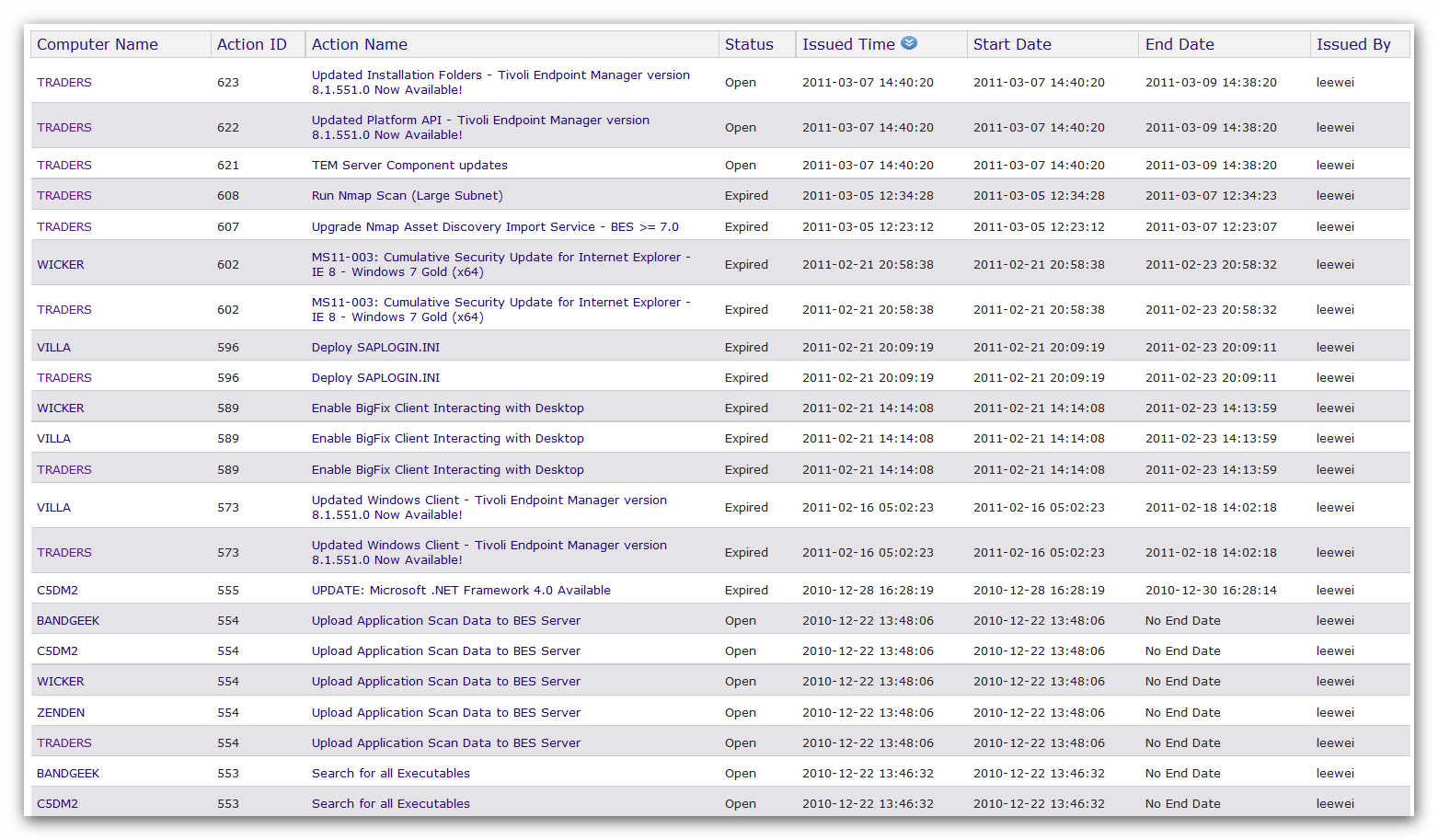

Shalva,
I have created a report with the action start/end times.
Please see if it is usable.
I have included a picture of the report in the first post so that it is easier for others who might benefit from this to see.
Lee Wei

Dear Lee, Thanks a lot, It was a great help from you… It worked out for me and fetching the data which i requried. But one small concern is that the issued by is showing the Action status, It is possible to check that option, if not no issues… I can still manage the show. :slight_smile:
Action Start/End Times
Computer Name Action ID Action Name Status Issued Time Start Date End Date Issued By
302011389L 42 Start SMS Agent Host Service - If Stopped Expired 2010-10-19 00:21:57 2010-10-19 00:21:57 2010-10-21 00:17:21 Expired
303009681LL 42 Start SMS Agent Host Service - If Stopped Expired 2010-10-19 00:21:57 2010-10-19 00:21:57 2010-10-21 00:17:21 Expired
326004895L 42 Start SMS Agent Host Service - If Stopped Expired 2010-10-19 00:21:57 2010-10-19 00:21:57 2010-10-21 00:17:21 Expired

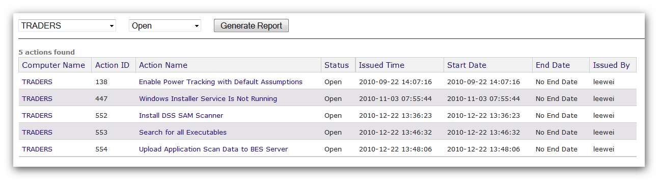

That looks to have fixled it Lee. However, I’m seeing some performance issues. I only have 240 actions within the console (some open, some closed, some expired), and this report is pulling back all of those as expected, and it is taking 10+ minutes to pull the list back. What do you think of having a pulldown to give the operator the option to only show (Open|Stopped|Expired)? Or someway to break the report down?
(imported comment written by Lee Wei)
I agree that it will be better to have a report with filters, otherwise, some deployments will have too much data.
I have added to the first post a version with filters.
This report is a little interesting (out of the ordinary) for a few reasons.
  • For version 8.1, in the Explore Data screen, we have yet to add filters for Actions.
  • The Start Date of an action is actually 2 different fields, one for the date, and the other the time_of_day. So we need to combine both to produce the start date.
  • Often the Start Date is empty, which means start the action right away. In this case, the start date is derived from Time Issued.
  • Lastly, the End Date for an action can be null, which makes it a “policy”, so we also need to take that into account as well.
Lee Wei
