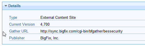

As of 17:03 UTC I’m seeing 4700 as the correct and current version in my console.
Could well be that between the time of your last gather and manually hitting the site URL, HCL had made some fixlet modifications and incremented the version accordingly.

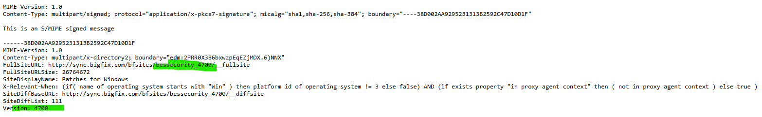

What does sync.bigfix.com resolve to for your main server? Wonder if its hitting a different server than others maybe hitting? Just for comparison purposes, I hit 169.62.91.99 and 169.61.68.131, both appear to have 4700 as the latest site
http://169.62.91.99/cgi-bin/bfgather/bessecurity
http://169.61.68.131/cgi-bin/bfgather/bessecurity
both show 4700
nslookup on sync.bigfix.com shows both IPs
