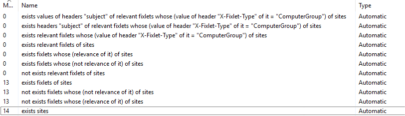

It appears the root of the issue is with relevant fixlets of <site> I can get this to produce output in actionscript with appendfile and can get it to produce a true in fixlet debugger using client context but the client doesn’t appear to like it (9.5.3).
Left column is applicable computer count, right column is the relevance for the group.
So… been doing some more testing on this… I also have a PMR open…
One thing I found interesting… The client on which I found this issue is at 9.2.5.130. I am able to reproduce in my lab which is at 9.5.2.56. BUT… My client has 2 stragglers that didn’t get upgraded and the clients are 9.0.649.0 and 9.0.835.0. On just those, the relevance works… So, something changed between 9.0 and 9.2 that broke this…

There are several things that specifically relate to fixlet values that can’t be used in evaluating fixlet relevance.
There was a defect that was addressed in 9.1 where the expressions mentioned here would possibly work and possibly not depending on the state so it was corrected to the intent which is to not allow for X-Relevant-When type cases to evaluate this.
If you can think of this scenario you can see why this is disallowed. The fixlet is relevant when there are no fixlets relevant in the site but then its relevant so it is not relevant then it is relevant again… etc etc
This is why we can’t use it in this scenario.
