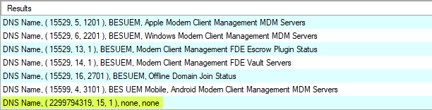

If this is due to the scenario @Aram describes, you can find out the property id by using this expression
(name of it, id of it, name of site of source analysis of it | "none", name of source analysis of it | "none") of bes properties whose (name of it = "DNS Name")
As DNS Name is a built in global property, its id should start with a long number which is the database id for your deployment, in my case thats 2299794319, and it will not have an analysis or site name.
Then, using this expression of the type mentioned by @Aram , you can call the exact property id which should prevent the empty data…unless the scenario @ageorgiev refers to is your root cause. Aside from a few minor edits, I used the Excel Connector to create this relevance.

This looks good, now I do have question my session relevance looks something like the below
(id of it as string | “not found”, names of it as string,
value of results from (BES Property “RAM”) of it | “not found”,
value of results from (BES Property “Device Type”) of it | “not found”,
value of results from (BES Property “dns name”) of it | “not found”
) of bes computers whose (last report time of it > now - 1 * hour)
it will return “not found” for every entry.
how could I rewrite this so it would use the ID
bes property whose (name of it = “DNS Name” and
(item 0 of it = 2299794319 and item 1 of it = 15 and item 2 of it = 1) of id of it)
I’ve got some experience with session relevance but this a bit over my head to be honest. I’m only interested in the property “DNS Name”. As Aram mentioned before I do have multiple properties called DNS Name so that explain why it would not return any data.
Any help would be appreciated
