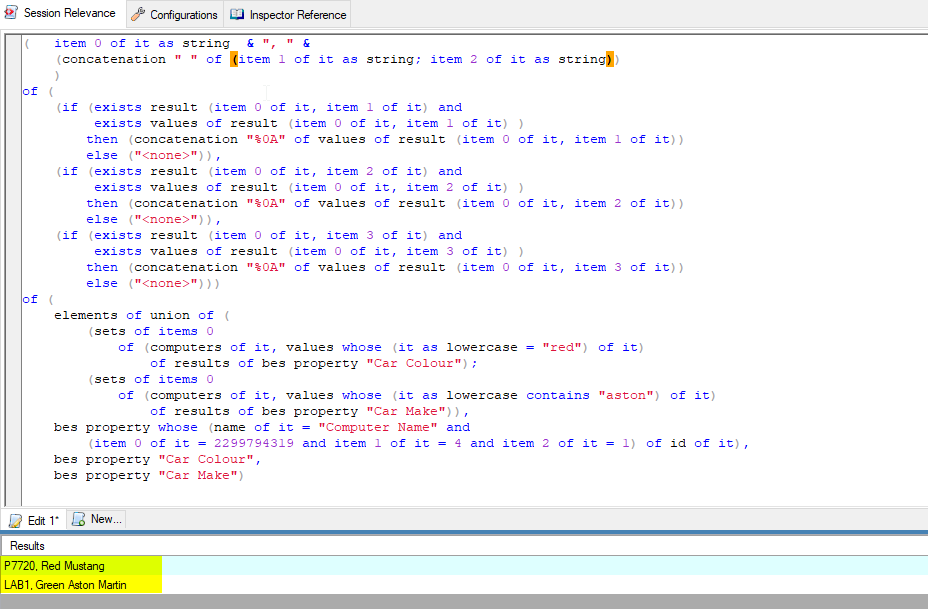

Is this what your trying to end up with?
Property data
Combined via session relevance
Very nearly…what I need is both simpler and more complex. Don’t need item 0 (computer name) at all and will do a unique values of on the concatenation.
Now reading through what you did here to see if I can understand it at all and get to the point described above on my own. :rofl:
Looking at the end, do you need to know what some of the values are (re: “red” and “aston”)? Ideally I’d be just going off of the data, whatever it may be. :thinking:
No, those flters wouldn’t be needed. TBH I’d started building the query based on looking for any red car or any aston but then re-read your requirements and changed my approach. I used the Excel Connector to build most of the relevance, then manually modified it to concatenation the make and colour into a single result.

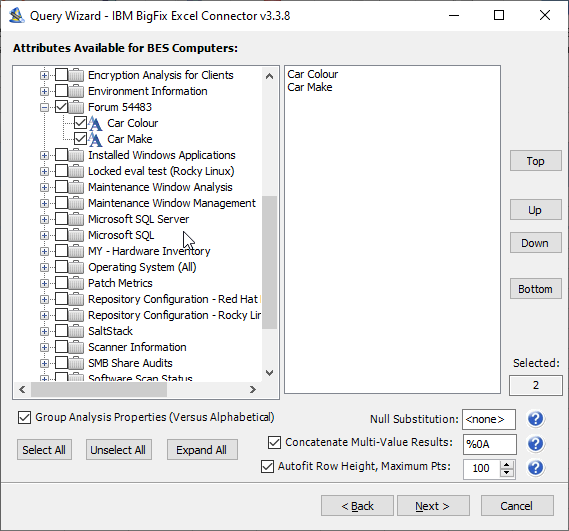

Okay… so, how do you get from the Excel Connector to this?? :open_mouth: I’m looking at the EC now…really haven’t used it much (at all, really) in decades.

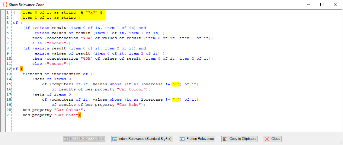

I then run the query and open the “Show Relevance Code” then edit the highlighted section with the relevance to concatenate the items and remove the white space from the filtering so it exclude devices with no reported data.
Got that far just after sending that. :laughing:
For this need, anyway, this was a lot easier than I thought. :joy:
