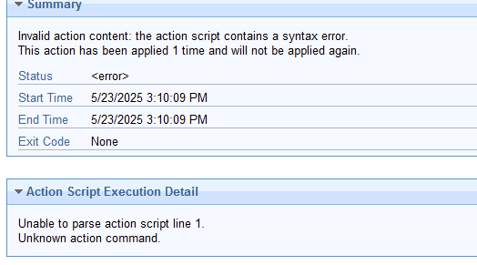

Some of the actions were reported as failed and when I looked into the actions’ details I noticed that some of the Fixlets(Components of baselines) are being reported with the following error:
This fixlet looks perfectly fine, and it is an out-of-the-box fixlet not a custom one.
I have checked and different Fixlets are being reported in the GA with that error.
The only way to avoid that is removing the baseline from the plan and re-adding it manually. However, that is exactly what we are trying to automate.
I may be missing some parameters on the initial creation of the plans but I can’t figure it out since I am not getting any kind of errors when sending the requests to the API.
