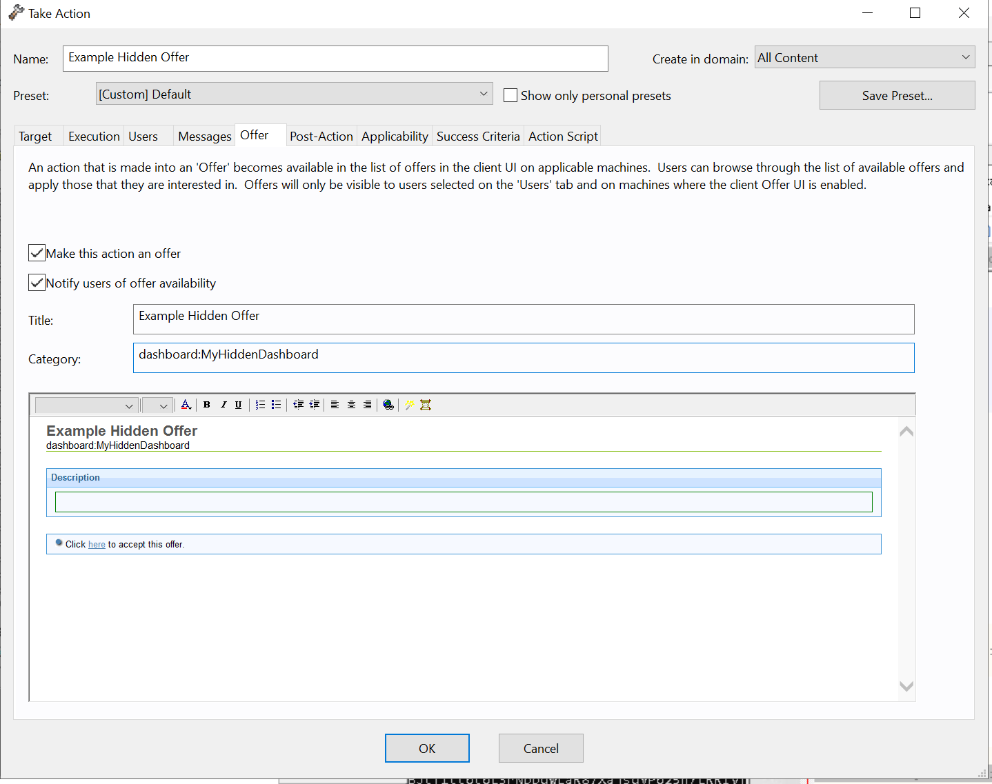

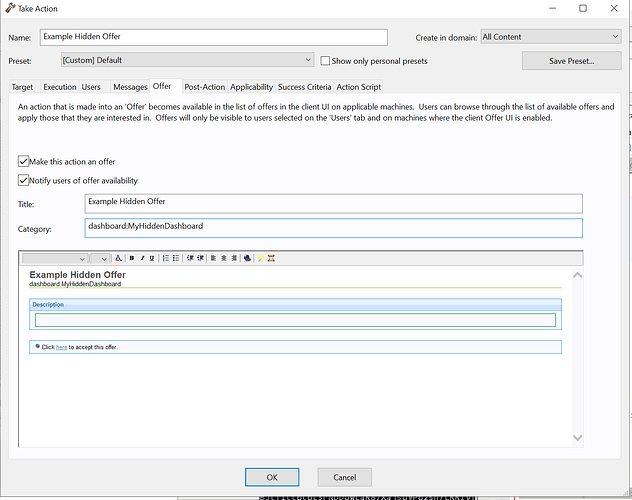

Hiding an Offer from the 'Offers' tab:
When you submit the Action, if you specify a 'Category' value that begins with "dashboard", that action is hidden from the default Offers tab of the BESClientUI / SSA. This allows for specific client-side dashboards to handle the offer exclusively - so we could have Software Distribution offers that don't clutter up the 'Offers' tab, and only appear in a SWD client dashboard page, for example.
We can leverage this to create an action that is hidden from the 'Offers' tab by default:
...then we could have a custom client dashboard that builds the table of links, that only includes our hidden-dashboard actions:
<table border="all">
<?relevance
  concatenation of trs of (td of html ("<a href=%22takeoffer:" & item 0 of it as string & "%22>" & item 1 of it & "</a>")) of (id of it, value of header "Subject" of it) of actions (ids of fixlets whose (value of header "X-Action-Component-Type" of it = "Action") of sites whose (type of it = "Master Action Site" or type of it = "Operator Site" or type of it = "Mailbox Site")) whose (offer of it and pending of it and value of header "offer-ui-category" of it = "dashboard:MyHiddenDashboard")
</table>
In that last piece, my original notebook actually had the offer-ui-category value as "dashboard%253aMyHiddenDashboard" - I'm not exactly sure which syntax is needed, my notebook has been translated through a few different tools over the users and that might be a botched character encoding. So the value there might be one of
dashboard%3aMyHiddenDashboard
If you dig into that, please post back which one is correct and I'll update it here.

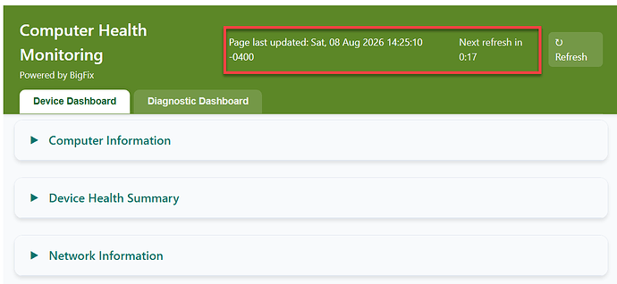

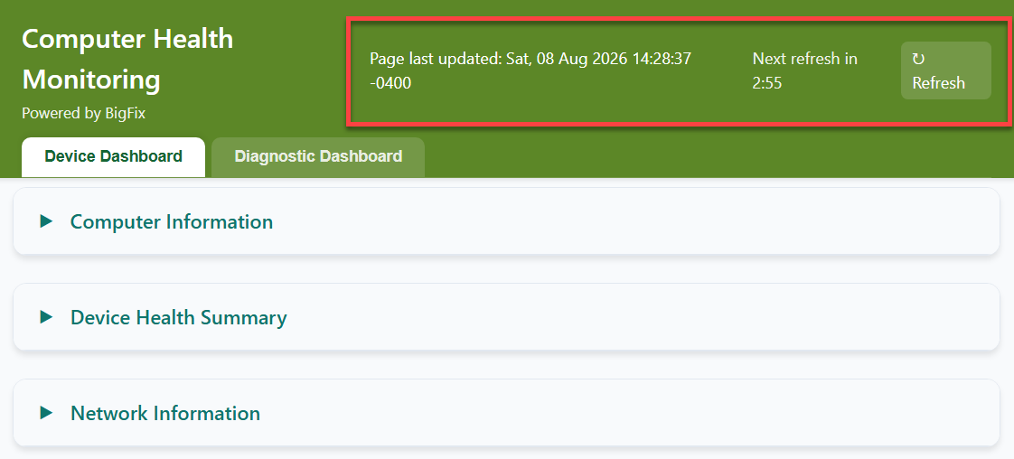

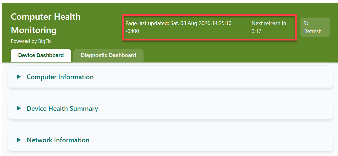

So... This is pretty cool. For the record my dashboard is still a work in progress and trying to work on it in my free time and it still has a bit of work to do on it. I have it counting down until the next refresh but I also have a manual refresh button as well which gets disabled if someone presses the manual refresh to prevent someone from clicking it repeatedly.
jgstew has a method for refreshing the content on his dashboard example but I did something slightly different with mine bigfix-content/clientui/offers/_dashboard.html at main · jgstew/bigfix-content · GitHub
I set mine to 3 minutes, so I didn't have to wait so long. (I get impatient)
Here is the
<div class="last-updated">
	<span>Page last updated: <?relevance now ?></span>
	<span id="refreshCountdown" style="margin-left: 12px; opacity: 0.9;">Next refresh in 5:00</span>
	<a class="refresh-btn" id="refreshBtn" href="javascript:void(0);" onclick="manualRefresh()">↻ Refresh</a>
</div>
Then I have a dashboard.js that I have some other javascript functions running from that I added this function to.
// ===== Auto-refresh every 3 minutes =====
(function() {
  const REFRESH_INTERVAL = 180; // seconds (3 minutes)
  let timeLeft = REFRESH_INTERVAL;
  function updateCountdown() {
    const el = document.getElementById("refreshCountdown");
    if (el) {
      const minutes = Math.floor(timeLeft / 60);
      const seconds = timeLeft % 60;
      el.textContent = "Next refresh in " + minutes + ":" + (seconds < 10 ? "0" : "") + seconds;
    if (timeLeft <= 0) {
      window.location.href = "cid:load?page=_dashboard.html";
    } else {
      timeLeft--;
      setTimeout(updateCountdown, 1000);
  // Start after page is ready
  window.addEventListener("load", function() {
    setTimeout(updateCountdown, 500);
// ===== Manual Refresh Button function + Disable Button ib click =====
function manualRefresh() {
  const btn = document.getElementById("refreshBtn");
  if (btn) {
    btn.style.opacity = "0.45";
    btn.style.pointerEvents = "none";   // disables clicking
    btn.textContent = "↻ Refreshing...";
  // Small delay then actually refresh
  setTimeout(function() {
  }, 150);
// Disable the button while the countdown is running so users can’t spam it right after a refresh
  if (btn) {
    // Keep it enabled on load, but you can force a short cooldown if desired
    btn.style.opacity = "1";
    btn.style.pointerEvents = "auto";
That looks great! Thanks for sharing, I'll be adding that timer to my dashboards :slight_smile:

@JasonWalker I finally got time to work on the actual offers last night and unfortunately it doesn't seem like adding dashboard: to the category hides it from the offers tab any longer.
I was able to confirm that the correct format for the relevance statement is
concatenation of trs of (td of html ("<a href=%22takeoffer:" & item 0 of it as string & "%22>" & item 1 of it & "</a>")) of (id of it, value of header "Subject" of it) of actions (ids of fixlets whose (value of header "X-Action-Component-Type" of it = "Action") of sites whose (type of it = "Master Action Site" or type of it = "Operator Site" or type of it = "Mailbox Site")) whose (offer of it and pending of it and value of header "offer-ui-category" of it = "dashboard%253aMyHiddenDashboard")
I did find a reference to a forum post where this was discussed in 2022 and apparently it wasn't working then either.
Self Service Technician Tab HTML - BigFix Forum
I'm posting this here Please Upvote this Idea if this is something you would like to see added back.
Self Service Application Category | HCL BigFix Ideas Portal
