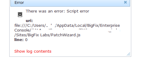

When trying to use the Windows Patch Wizard I get a script error message
Other wizards and dashboards seem to work with no issues. I have tried deleting the cache and running as a different id, but still have the same issue. This seems to only be happening on one workstation, so it has to be specific to this system. Any ideas on troubleshooting this?

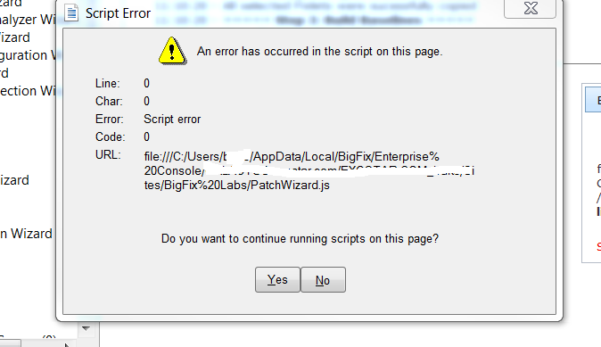

I was in the process of pushing out patching using the patch windows patch wizard, I have selected year:2016: Months: April
and in the filter I have put in Windows 7. I have select all the patches for windows 7, select next, I chosen Build action, and Copy filets to the custom site, <img, src=“/uploads/default/original/2X/1/1f23ec8bdd17bfeecb8014109340607d7d6bbb16.PNG” width=“690” height=“370”>
Than, I have select next.
Hi sbak,
Thanks for the steps to reproduce, and yes I can reproduce this in my environment. We will proceed to fix it and update this thread when that’s done.
As a workaround, you may want to try ‘Build Baseline’ instead of ‘Build Action’.
Thank you!
