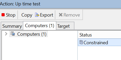

Run Job as soon as device is rebooted
I am trying to create one deployment condition as soon as machine is rebooted, one of the Job gets applied. So I created a custom property UPTIMEMINUTES and using the constraint to run only when UPTIMESMINUTES is less than 10 mins(sample). Still job is going to constraint status until its hitting 10 mins of UPTIME. Any thoughts on this. Ideally it should execute
