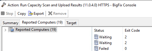

Running patch 4 (released last week) and get:
Anyone else seen this yet?
Case was opened.
Quality Assurance seems to be a lost art these days.
Case was opened.

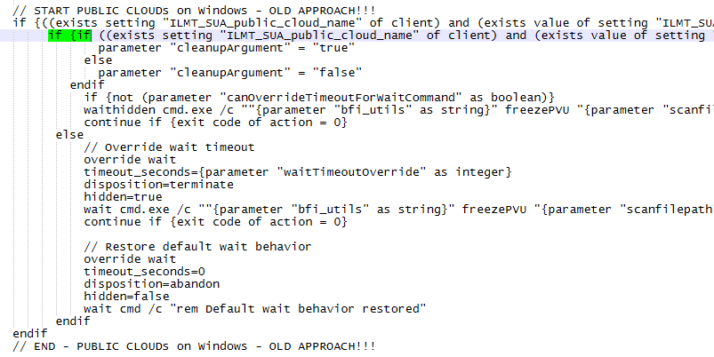

The error is in this block of code. There is an extra ‘if’ inside the relevance susbstitution of the failed line.
// START PUBLIC CLOUDs on Windows - OLD APPROACH!!!
Failed if {if ((exists setting "ILMT_SUA_public_cloud_name" of client) and (exists value of setting "ILMT_SUA_public_cloud_name" of client) and not ((exists setting "ILMT_SUA_fixed_processor_rate" of client) and (exists value of setting "ILMT_SUA_fixed_processor_rate" of client)))}

Since there is no If/then/else inside the relevance, I presumed it was extraneous.
It is line 369 of the action script.

Yes, this part was confirmed as incorrect relevance. Team was testing the solution within the lab in the last hours to assure no other issues. Once confirmed the fix will be shared through the support case and the fixlet site will be refreshed as a next step. Thank you for bringing this to our attention. Indeed we need to assure this will not happen again.

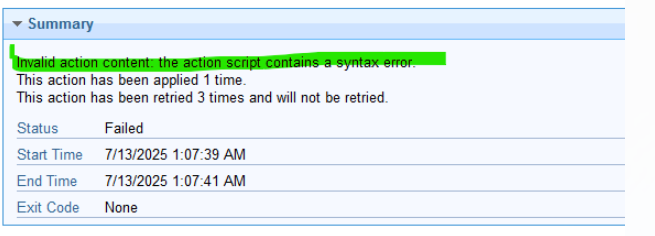

I am seeing rc=2 failed and rc=0 failed (100% failure rate) for Run Capacity Scan and Upload Results (11.0.4.0) on FedRAMP but will have to open a case over there.
The waiting is we try 3 times on the baseline that this task is running in and then fail.
