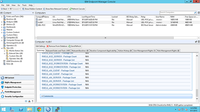

RHEL patches not applicable
I’ve recently deployed a client on RHEL 5 and manually check for the updates on the server. What I found that old versions of RPM’s are installed on server and BigFix suppose to identify those updates. But there is not even a single relevant fixlet showing in BigFix server. I activated an analysis to view installed RPM’s but not even a single package is displayed in console.
I’ve subscribed the endpoint to all the relevant Linux patching support sites as well. Then I tried enable USGCB CHECKLIST FOR RHEL 5 and the fixlets of that RHEL server are shown as relevant.
For convenience I’m attaching a log file and screen shot as well.Can anyone please identify what is wrong with that(mentioning that I’m facing same issue with both RHEL endpoints).
Below is the Log file of client :

Start monitoring action - Heartbeat Analysis (fixlet:2)
Relevant - Installed Windows Patches Information (fixlet:37)
Relevant - custom analysis (fixlet:46)

@steve @TimRice @jmaple @vikki need help.
Is your client subscribed to the RHEL5 patching site?
Hi @jmaple
Yes the client is subscribed to RHEL 5 patching site and also for Native tool and Dependency resolution site and also to the Linux RPM Patching site.
Though client is not updated and it need updates to critical packages like SSH, SNMP, SAMBA etc because I manually check the system and all the rpm installed on it are outdated and need to be updated. My Query is that these fixes should be applicable to the client and the analysis is also not fetching the list of installed RPM’s.
Wondering that we haven’t patched that system for many time and the patches are needed on the client. Is there any exception occurred that preventing client to become applicable to those fixes and analysis? Any service that need to be start or anything else?
Well all the fixlets from the RHEL patching sites query RPM to determine relevance. I have a similar issue on a few servers of mine and I can only assume, at this point, it could be the version of RPM that IEM can’t query? I have another thread asking about how the RPM inspector works.
@jmaple did you subscribe your RHEL server to the other sites like “USGCB Checklist” or “DISA Checklist”
Can you please specify which service need to be running which require BigFix server to query Rpm database?
Have you check that analysis like “Installed RPM packages” are working?
Because in my case this analysis is not fetching the list of installed RPM as well.
Well there are no particular sites in question here. There is a relevance inspector that handles this. The inspector is what doesn’t seem to be working correctly on these servers. The analysis you allude to does not have any results. The result is 0.
