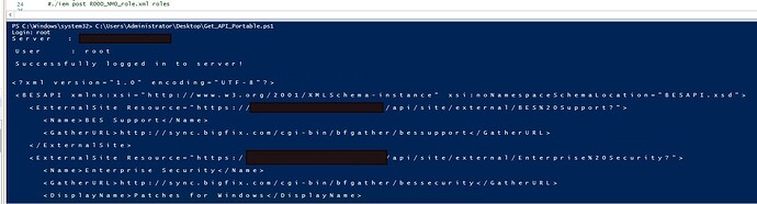

In the BIGFIX 9.5 we face the issue with generate the xml with code below.
./iem login --server=$server_ip --user=$login --password=$pass
./iem get sites
The result is xml i full “spaces” between each char. Any ideas ??

Would you be able to share a screenshot or similar to help with context? Have you attempted to redirect the output to a file to then open to check/validate the characters in question?
Hello
I have tried many ways to save the output. out-file, export-clixml etc. the results are the same. Please check the output from the console.

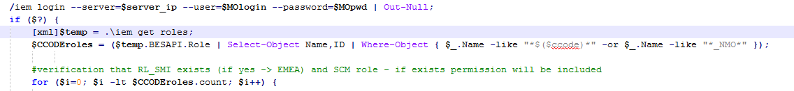

In bigfix 9.1 or 9.2 we do not have any issues with:
./iem get sites

I have tried with my 9.5.3.211 on Japanese Windows.
When I run iem.exe from command window, the result looks good, both on command window and redirected file. (No “space” in XML).
But when I run iem.exe from PowerShell, I got the same result as yours.
