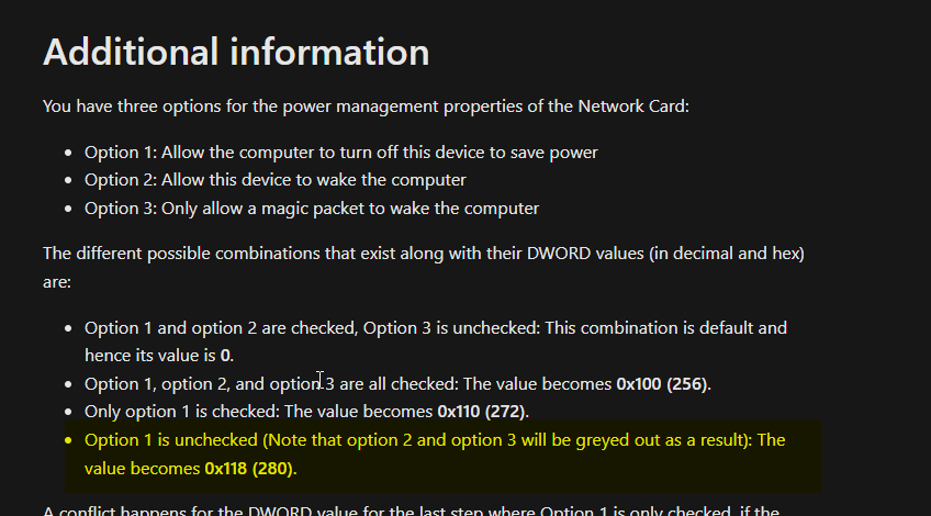

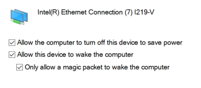

This article is old, but I think still valid:

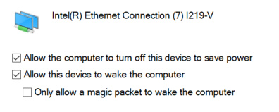

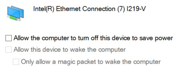

Adapter with PnPCapabilities not present or set to 0:
Adapter with PnPCapabilities set to decimal 16:
Adapter with PnPCapabilties set to decimal 24:
Adapter with PnPCapabilities set to decimal 256:
From the article:
You have three options for the power management properties of the Network Card:
Option 1: Allow the computer to turn off this device to save power
Option 2: Allow this device to wake the computer
Option 3: Only allow a magic packet to wake the computer
The different possible combinations that exist along with their DWORD values (in decimal and hex) are:
Option 1 and option 2 are checked, Option 3 is unchecked: This combination is default and hence its value is 0.
Option 1, option 2, and option 3 are all checked: The value becomes 0x100 (256).
Only option 1 is checked: The value becomes 0x110 (272).
Option 1 is unchecked (Note that option 2 and option 3 will be greyed out as a result): The value becomes 0x118 (280).
I don’t think 280 is an expected state? But it’s not really clear to me from the article.

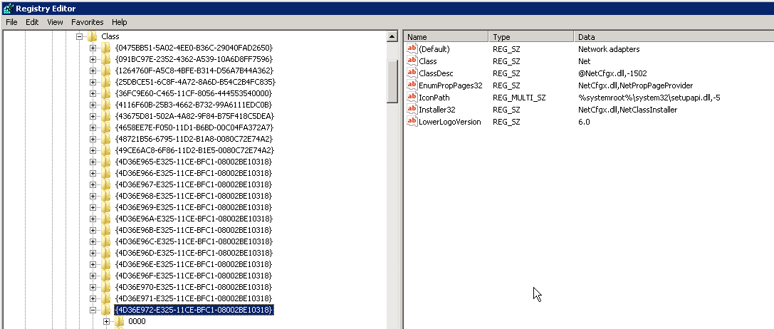

I want to add another condition without breaking this. You can see in the image below there are several keys with the same GUID name ending in 318. How do we filter out so only if this GUID has class = net?
So I want that added before this.

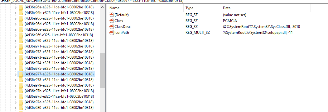

It’s not always Net, which is why we are having a problem. The fixlet turned off the power saving option but the relevance is still true.
We want to filter out all the noise and only search this GUIDs subkey when the class equals net.

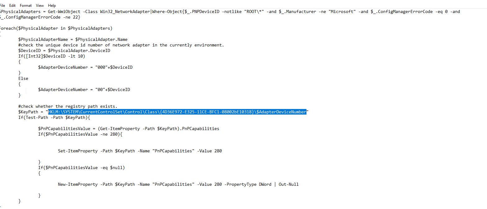

But…the guid in your screenshot does not match the GUID you’re searching here. So what is your actionscript doing?
Good catch, I completely missed that. I looked at the action script, which was create a couple years ago by someone else, and the problem is that they created it wrong. It’s doing REG_SZ instead of DWORD.
