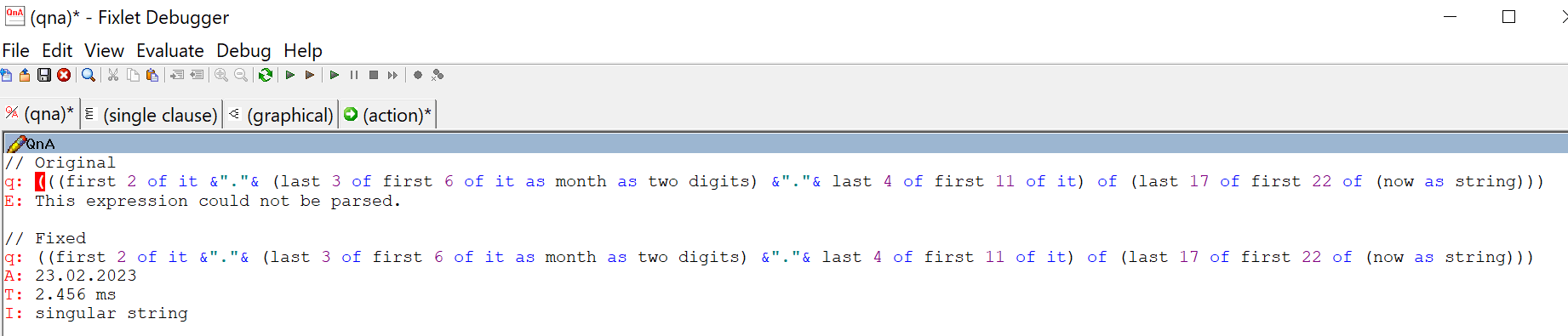

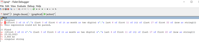

Then the relevance statement itself has a problem (likely because you’re casting now as string and then trying to pull months out of it? Or maybe parentheses?
First try it (without curly brackets) in the ‘Single Clause’ tab of Fixlet Debugger; then (with curly brackets) in the Action tab with the parameter statement
YES!!! That and the squiggly brackets makes it functional. Thanks!
