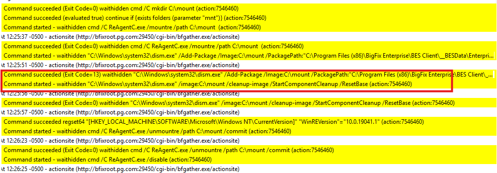

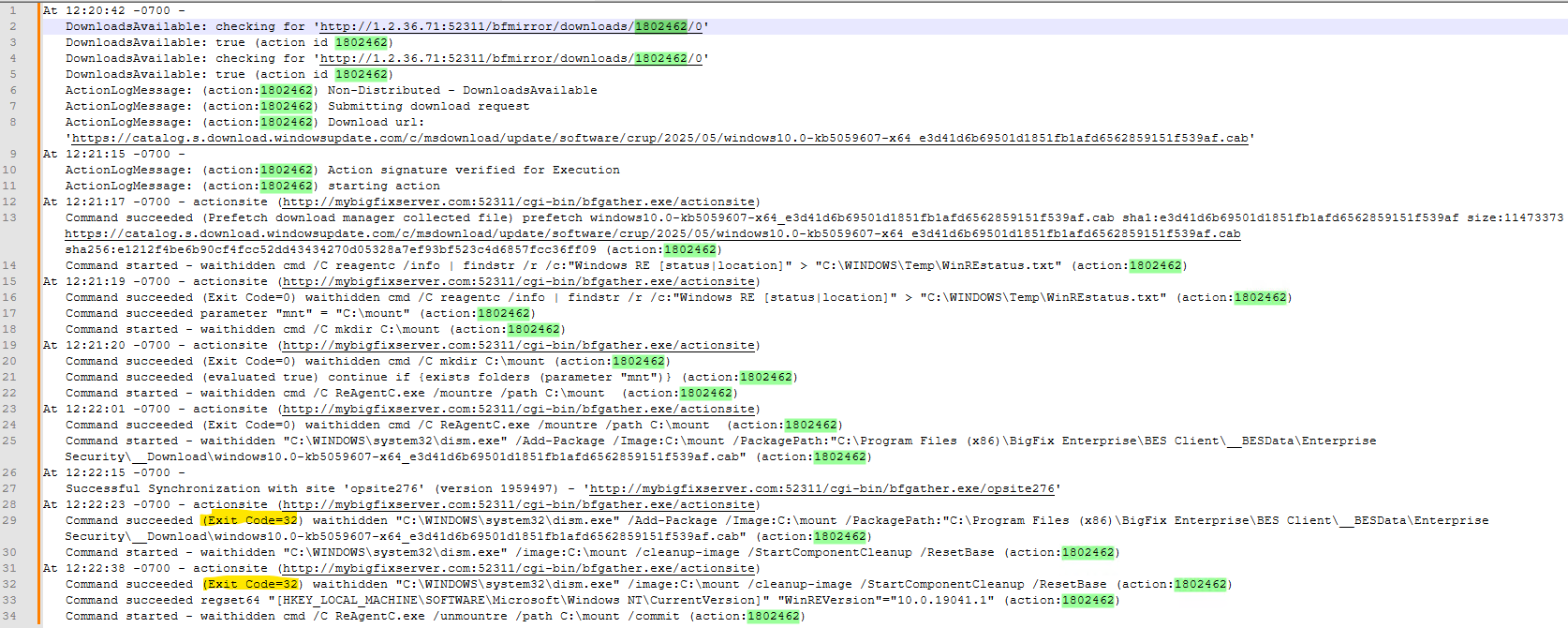

can you check the log and see what the results were?
Mind show error 32 while executing the dism command.
Everywhere I search, Error 32 for DISM shows that the command mounted to “X:” instead of “C:” but the command below checks for the mount, so I am not sure what is happening.

For me, error code is 13

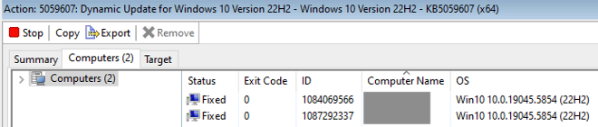

I just ran this fixlet against 2 different endpoints and it successfully worked in my environment. I would really like to understand the differences preventing this fixlet from successfully running in your deployment.
