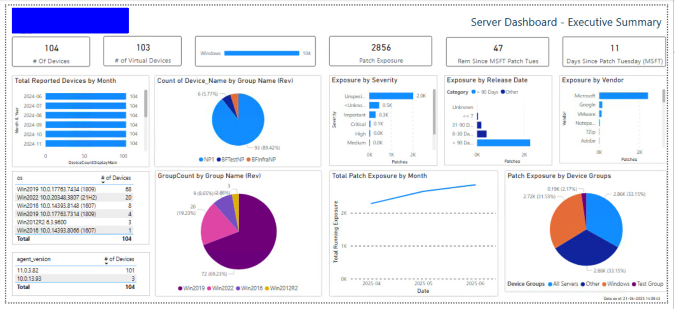

This is the main (executive summary) dashboard, which uses the same queries provided by BigFix in files DeviceInventory.pbix and PatchRemediation.pbix.

I’m a bit confused, if we removed all the older data from BFInsights, then it would not be possible to retrieve values for most of that dashboard.
‘Total Reported Devices by Month’ for example relies on having records from prior months.
Can you give an example of one of the queries that is giving you data older than you expect? I think you’ll need to tune your query to filter out any older records you don’t want.
