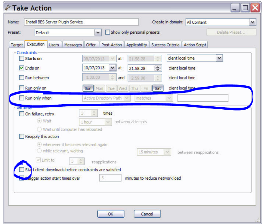

Have you tested, on the “Execution” tab of the action, simply only having it apply from 10pm to 6am?
I’m not sure there is a great solution to pause the download during the day other than enabling bandwidth throttling during the day and disabling it at night.

Do they need to actually pause the download, or just not run the installer? This might be similar to the use case of “precache a lot of OS patches before running them in a scheduled window”.
What I do for this, is to issue the patching action with the checkbox set for “Begin downloads before constraints are met” (so background downloads begin immediately), and a Constraint based off a client setting (I use PatchWindow != “Closed”). I kick off the patching action a day or two ahead of time and give the clients time to download all of their applicable patches, then send separate actions to toggle the client setting “PatchWindow” between “Open” and “Closed” based on our schedule.
Another handy thing about sending actions that way, is that I can issue a single set of baseline actions against large numbers of our systems, and toggle their PatchWindow value in smaller groups or on an individual basis to minimize outages.
