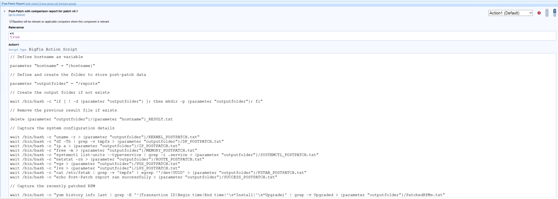

I have few pre-patch fixlet that has its own success criteria if the outfile file /report/success_prepatch.txt exists then the fixlet is success else fail.
And same applicable to post it has /report/success_postpatch.txt

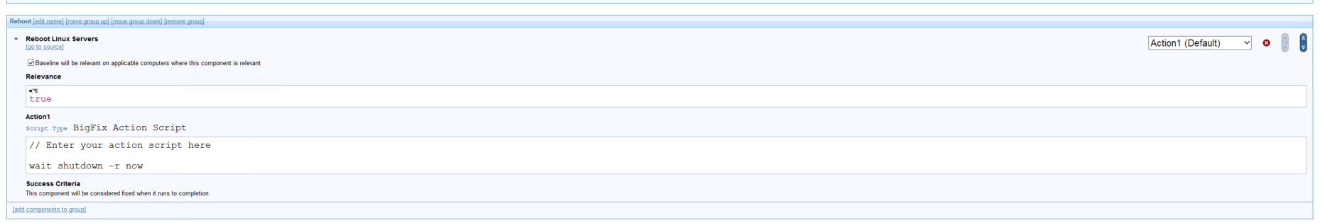

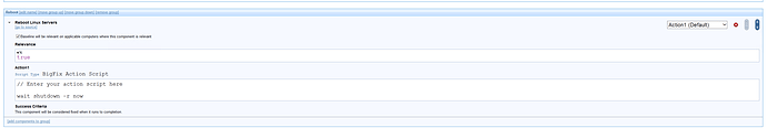

Also, I have reboot fixlet which has success criteria in which all lines of commands are executed means it will success else fail.

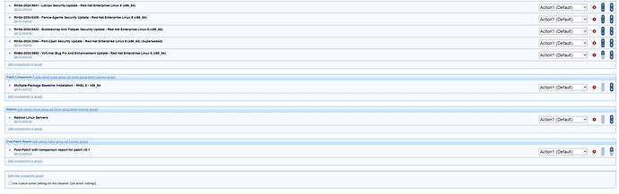

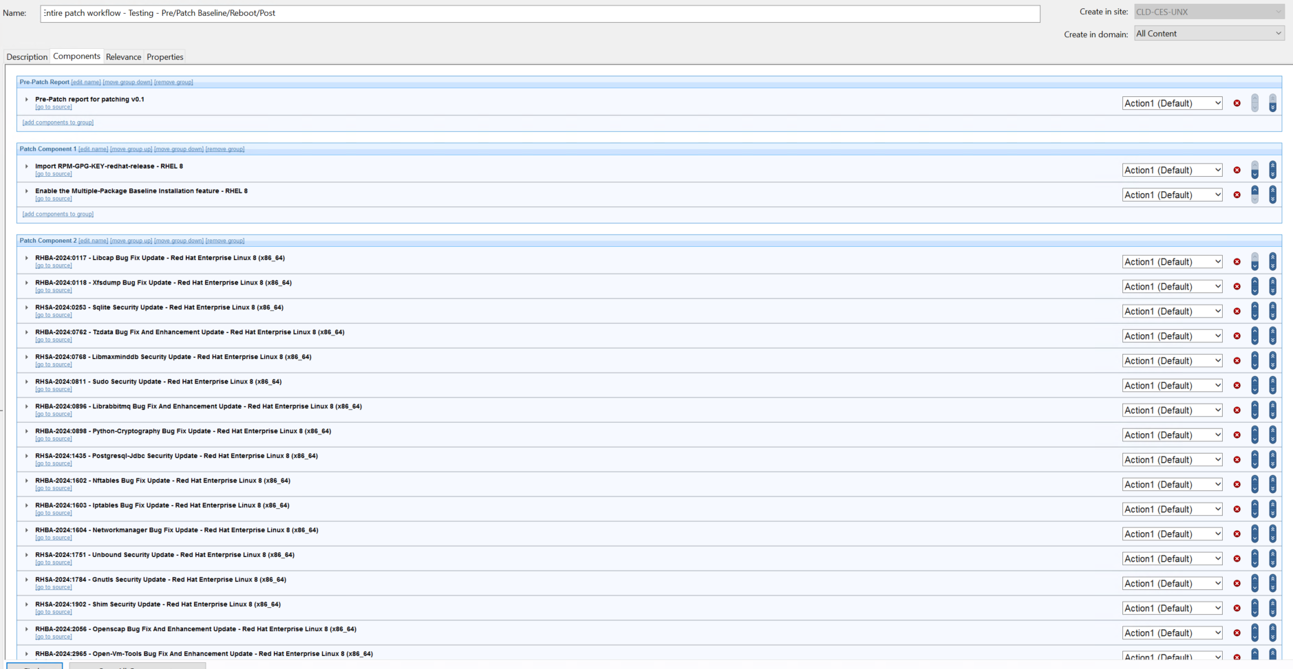

I have created a workflow baseline as below,
  1. Component group (pre-fixlet)
  2. Component group (Patch baseline)
  3. Component group (Reboot)
  4. Component group (post-fixlet)
Let’s say if I created like the above, how the workflow will work. Is it based on the order I created. If yes, then how it will see whether the step 1 is success or fail.

Another thing, for step 3 there is reboot fixlet. If step 3 executed then how will the step 4 will run, will the step 4 will wait for the server to come back online.

From what you have mentioned I understand is regardless of success or failure the complete baseline will run from top to bottom. Just want clarification on reboot portion only, so when we execute reboot (step3), the step 4 will wait until the server comes online or the step 4 have any time limit to skip/fail. Thanks.
Yes, it will wait!
see below post from @JasonWalker for better clarity on reboot & wait.

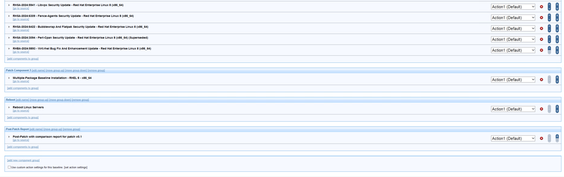

Just add to this, I will attach my complete baseline here before going for testing. kindly advice if anything need changes or modification.
Looks good to me, but before going for mass roll out, please do test it on your test devices 1st.

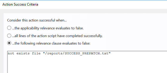

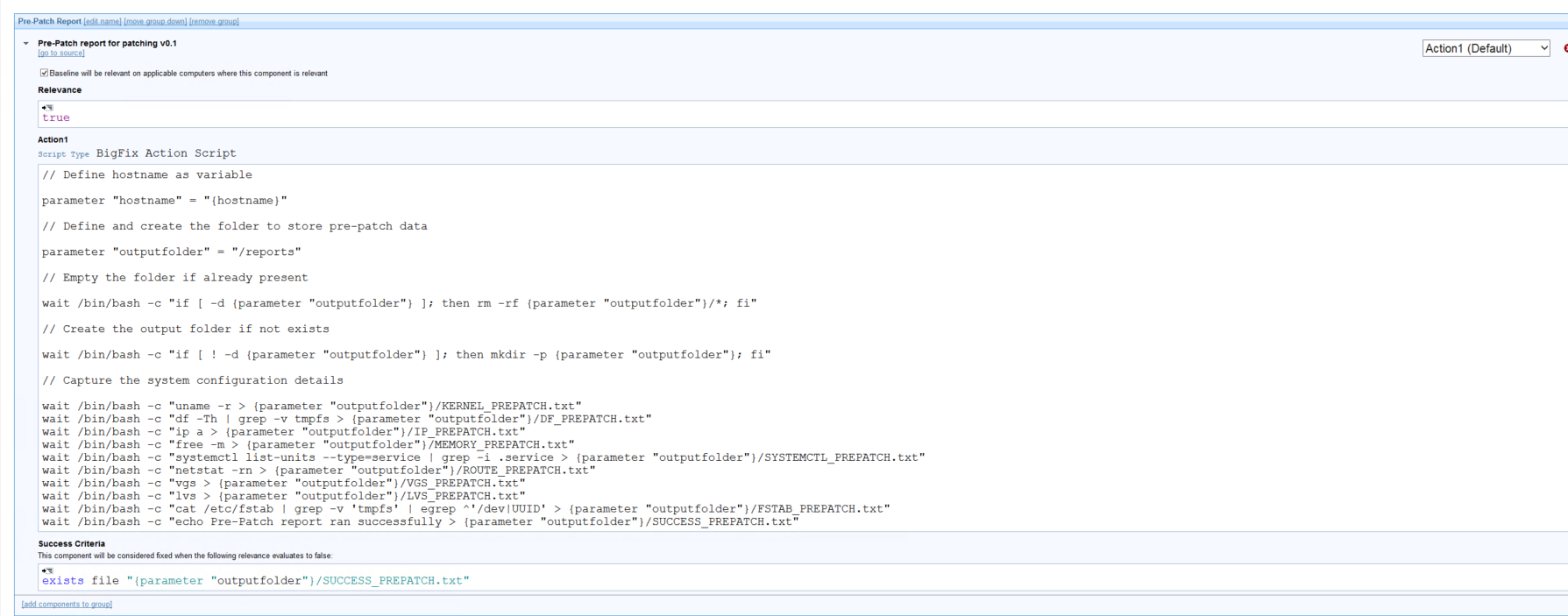

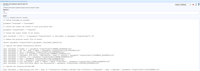

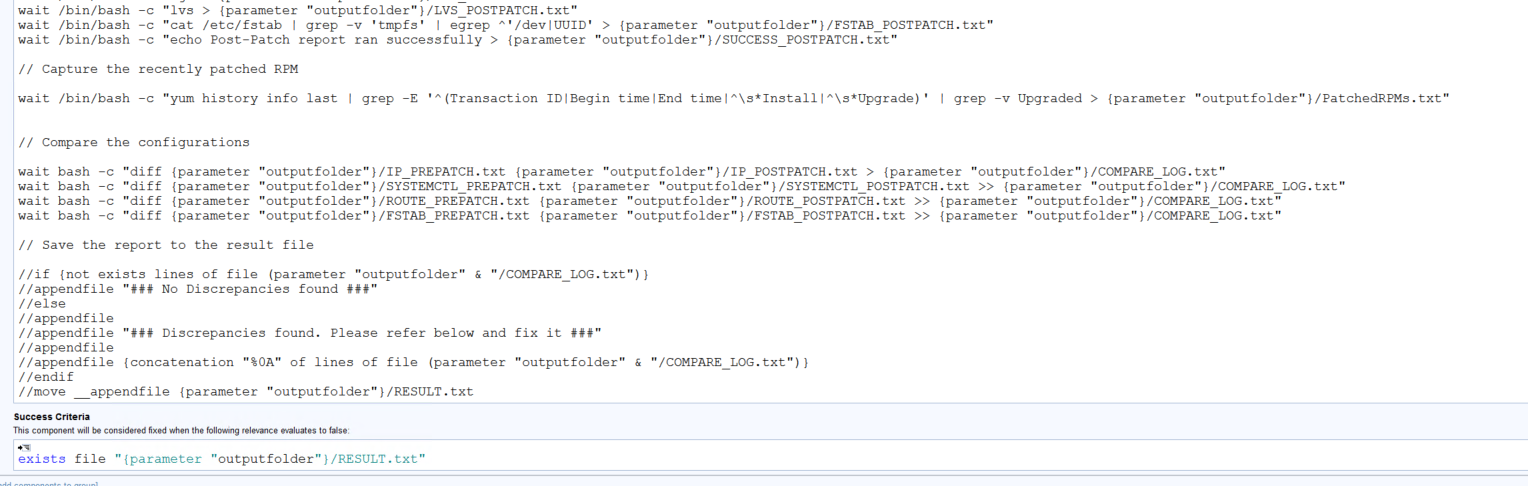

my bad ! I didn’t see the significance or your script, but I just realized that your success conditions are off.
The parameter must be hard coded because Relevance is unable to decode it outside of actionscript.
It needs to be as follows:
not exists file "/reports/success_prepatch.txt"
Likewise, for your post script success criteria.
Hi Khurava,
GM. Thank you for your support.
Sure will take note of the above and will try on one server first. Thanks.
Hi khurava,
sorry bit confused about the relevance.
I understand as we need to hard core the value instead of parameter but why we need to put not exists file instead of exists file as I want to check if the file exists then success else fail.

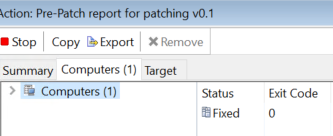

I changed as per your advice but the result status is showing fixed instead of success.
And the main relevance is as below,
My main agenda is I want to check the file exists and then it is success if not fail as a result not fixed.
In short Success = Fixed!
refer to below link for action statues:
Action Status Messages | BigFix Developer
You have already answered your question; that is exactly what we have done when we state not exists… and evaluate as FALSE.
Action Success Criteria states: Consider this action successful when …the following relevance clause evaluates to FALSE.
If we say exist file…, it will return True rather than False, indicating that your success criteria is failing, whereas not exists… will return False rather than True, indicating that the file exists.
