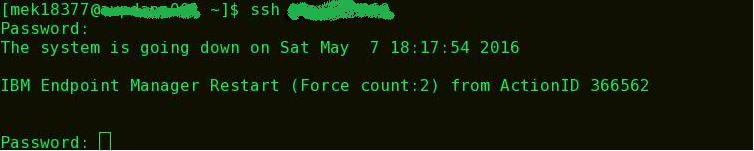

unable to access the servers. We got the below error while trying to
access the servers.
We found that there is a file created /etc/nologin and it
is not allowing any of the user to access the servers. We rebooted the
server one more time, go to the single user mode and deleted the file.
We rebooted the server and able to access the server. Kindly check and let us know is there any solution for this issue.
We need help to get rid of it as every time we are doing patching for RHEL 5 and then we are unable to login
If a shutdown is scheduled for the future, it will create the advisory file /etc/nologin which causes programs such as login not to allow new user logins.
As the warning says " is GOING down on ", it seems the system is in the middle of a shutdown.

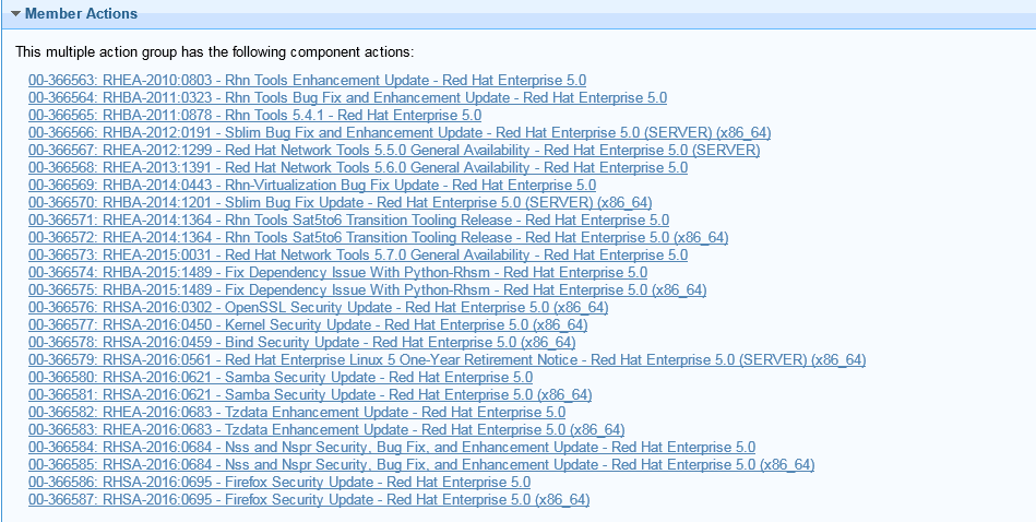

May I know which fixlet is used to deploy this action 366562 ?
@ChuxinZhao Below are the list of fixlet which was applied to the Servers

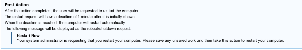

In Post action we have mentioned that server should be restarted once the patches are deployed.Please see the below screen shot :thumbsdown:

ok but Just now I saw the log file and I got the below finding.
And when I checked this fixlet “46” it was not included in the baseline which I took action.
