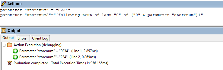

Just wondering if there was another approach by appending a leading “0” then parsing the text after the last “0” which would drop off any leading 0, be there 1 or 2 of them
parameter "storenum2"="{following text of last "0" of ("0" & parameter "storenum")}"
Edit: Ditch that idea, easier to cast to integer as @JasonWalker already shows :blush:
