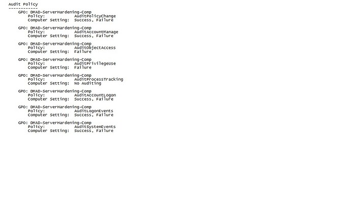

Perhaps the example of the source file is not sufficient for the relevance?
It is pretty lengthy, I just cut out one section of it.
The lines are separate lines and laid out exactly like you specified in the original?

Actually each section of it starts with:
Account Policies
Audit Policy
etc…
Underneath the Policy is:
ugh, they are dashes -----
So because the the file format is different then you probably need:
q: ((previous lines of it;it;next lines of it) of lines whose (it starts with "Policy:" and it contains "LockoutDuration") of it) of file "c:\temp\test.txt"
Ok, so I think the problem is that “GPO:” is not at the start of the line - there are spaces before it. You can automatically trim the leading/trailing spaces casting “as trimmed string”. So try
q: ((previous line of it as trimmed string;it as trimmed string;next line of it as trimmed string) of lines whose (it as trimmed string starts with "Policy: LockoutDuration") of it) of file "d:\GPO.txt"
The important part in the comparison is whose (it as trimmed string starts with "Policy: LockoutDuration") of it ; the casting in the results is just for our readability.
