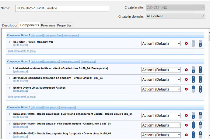

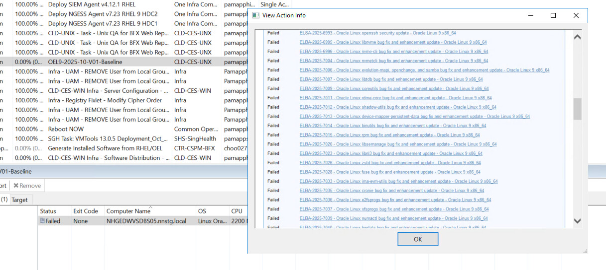

Team,
We try to patch the oracle server 9 server using bigfix baseline but all the packages are getting failed.
However, we just tried to search and install the same package using yum, we can able to see the package and its available for install using yum.
Also we noticed in the EDR logs it shows dependency resolution failed and exit code 1.
120204 : 2025-10-23 17:18:45 : ERROR : dnf command not continue, last command exit code is not 0

120224 : 2025-10-23 17:18:49 : ERROR : Dependency resolution failed.
120224 : 2025-10-23 17:18:49 : ERROR : Exit Code: 1

Error: No match for argument: kernel-uek-5.15.0-312.187.5.3.el9uek.x86_64

Yes we are using the fixlet by bigfix and we created a baseline using the fixlets.
