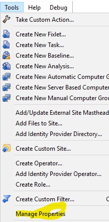

In the console, go to Tools, then Manage Properties.
Find the “Last Report Time” property or properties. The one you should be using should say “Reserved”. If there are more than one property called “Last Report Time”, you need to make sure you are using the reserved one.
