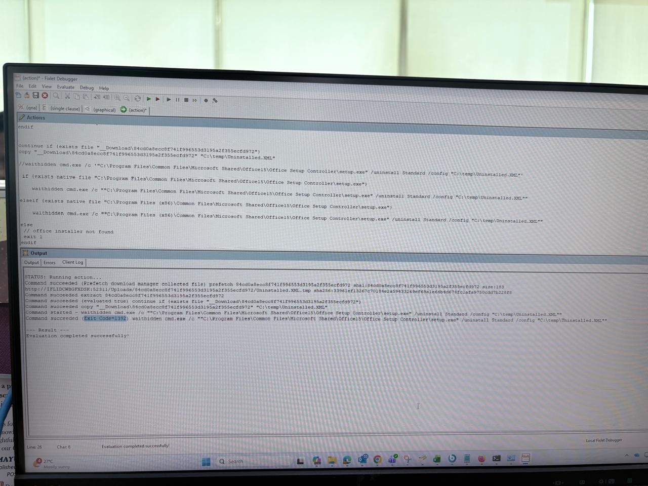

I have tried above solution provided by you.
I got the different error message.

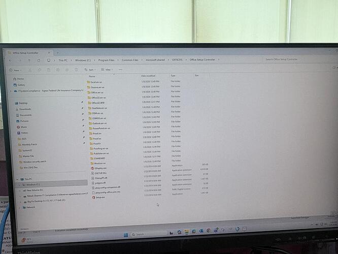

As you can see in screenshot setup.exe is already present. Even I have tried in different machines and got the same error.
Your screenshots are really hard to read, but I don't think I see a action uses wow64 redirection false in there
Hello Jason,
action uses wow64 redirection false was there but it was not captured in the ss.
Ok, then, I'd suspect an issue with your XML file. That error number 1392 corresponds to 'invalid directory' so maybe one of the paths from the XML is not correct - especially since you'd probably need different XML files for x32 versus x64?
