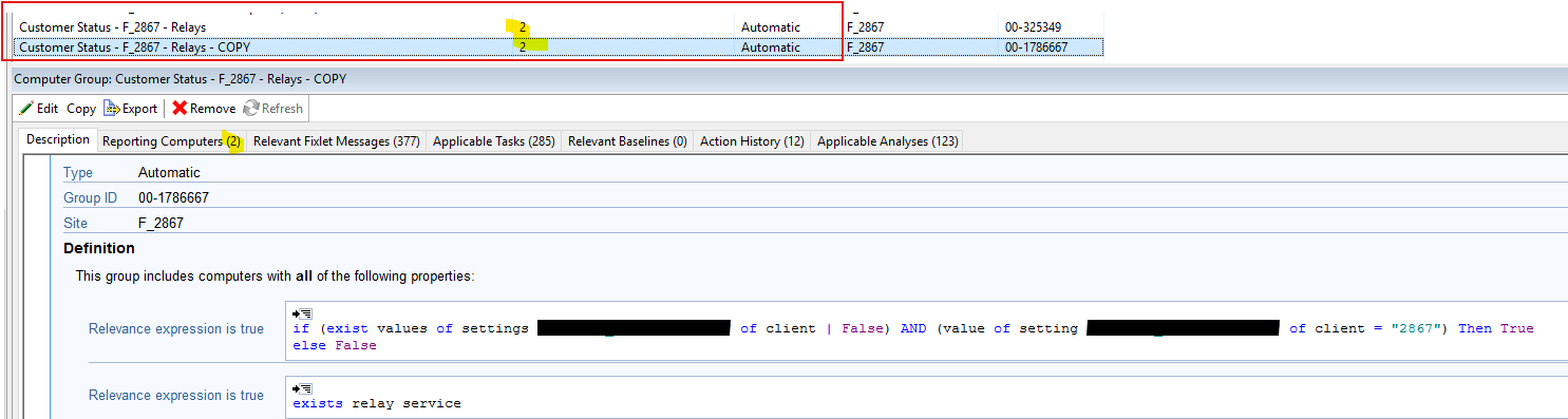

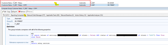

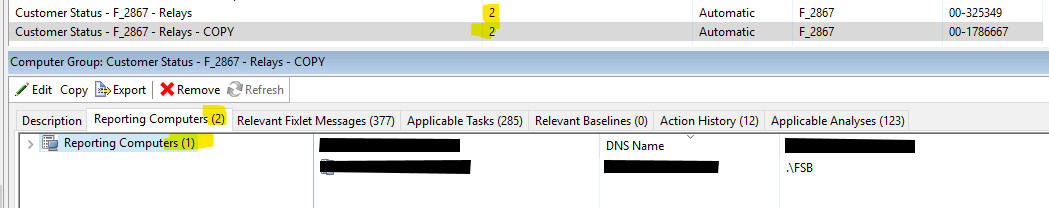

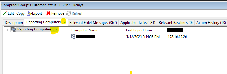

The site I used in the ticket (And the screenshot above) is a customer that has only, and has HAD only one relay, for months.
Funny thing, that example, customer, site, only shows two systems on the TAB and there is still only one in the list.
I made a copy of the one group and added the site relevance to the copy, but they still show the same count.
