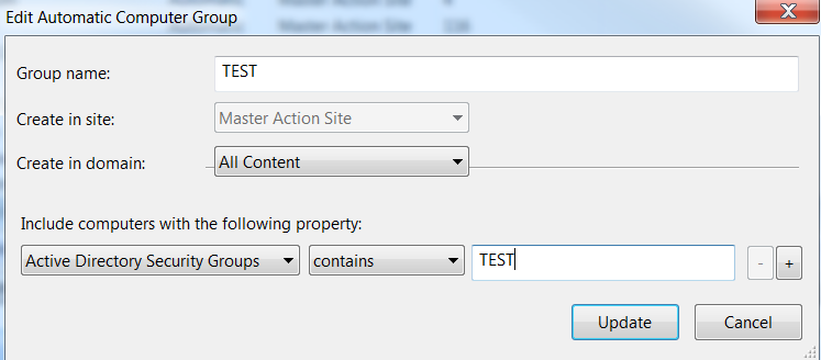

You can create Auto Group which will pull only PC are on Global Security Group. You can ran Fixlate/Task on that group with Dynamically Target By property to make task Automated.
